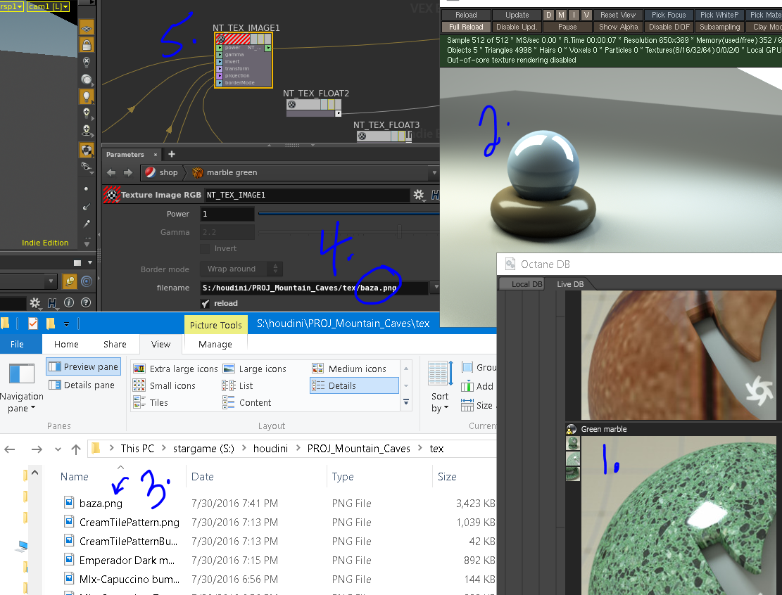

Hello,
The imported materials from the Live DB do not seem to be using the textures - unless I'm doing something wrong?
1. I imported this texture from LiveDB
2. I applied it to this sphere
3. The texture definitely exists...
4. Here is the path to the texture
5. I'm getting the error markings on this node which are:
"Input datatype does not match output for input 'gamma'
Input datatype does not match output for input 'invert'
Input datatype does not match output for input 'transform'
Input datatype does not match output for input 'borderMode'
I've tried several different LiveDB materials and none of them seem to reflect what is shown in the preview image in LIveDB
Thank you!
Win10
Nvidia Quadro K5200
32GB
OctaneRender Standalone Ver. 3.0
OctaneRender Plugin Ver. 3.0
Houdini 15.5.523 Indie
