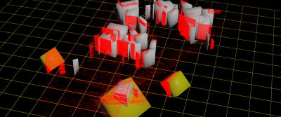

hey juanjgon, on closer inspection, it seems to be a instancing problem and not a camera problem.
look at the following attachment. the yellow geometry is normal geometry objects. the grey are instanced geometry. the red pointcloud is the position pass from the rendered image.
the position data is accurate for the normal geometry objects, however offset for all the instanced objects.
Hmm, weird. I am going to need the scene see where is the problem. Can be a problem with the transformations of the object to be instanced, at OBJ level or at SOP level ... it is hard to say without the scene.
