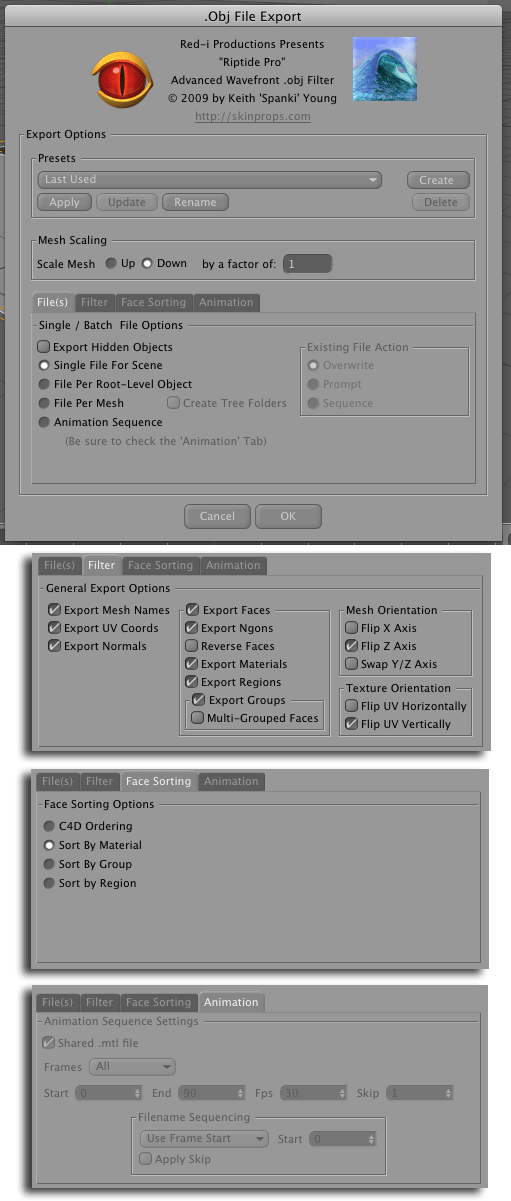

Here are my settings!

Hi keithkml,
You should try to export without n-gons. Try to uncheck the "Export Ngons" in the second screenshot.
I'm not totaly sure but i think it's one possible reason of your crash.

Thanks for the tip, but unfortunately it still crashes with N-gons disabled. It even crashes when I disable the "export faces" section completely. In fact, it still crashes when I disable everything in the export tab.
