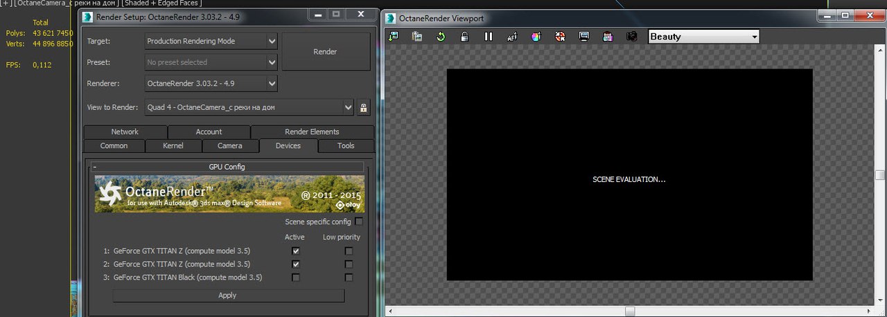

2х Titan Z +titan black = 6Gb
with memory errors
2.25 octane everything works
3.03 4,10 not enough memory
tested , it is an error only in 3 versions
3ds max 3.03 4,10 with memory errors
C. RAM Capacity (i.e. 6 GB)

video memory, the old (2.25) version works fineazen wrote:Hi,
Just to clarify, you are referring to System memory as opposed to GPU RAM. Is that correct? Please confirm whether these errors are CUDA errors, or if they are system memory errors.
Win11/msi x79a-gd45 (8d)/ Intel Xeon e5 2690v0/ 64gb DDR3 1866/ Nvidia 4090 Asus TUF/ be quiet! Straight Power 11 1000W 80 Plus Platinum
I have the same problem with Cinema 4D plugin and 4x980TI.
Tested same scenes on V2 and it works perfectly. Is there a fix?
Win 10x64, AMD 1950x 16C/32T, RAM 32Gb, 4x EVGA GTX 1080Ti, Octane-for-C4D 4.x.x, Nvidia 398.82
