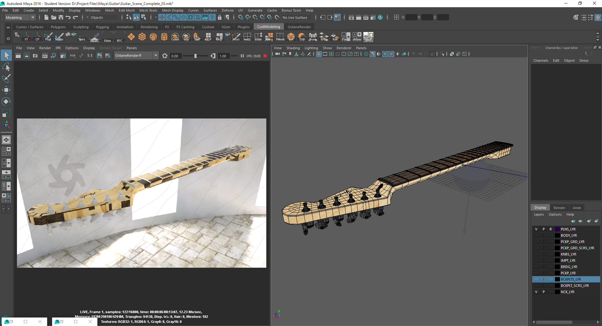

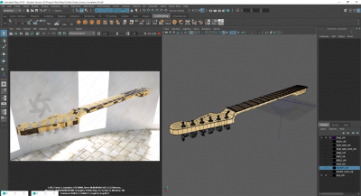

I've been modeling something for my portfolio and crossed paths with a rendering problem. After I UV unwrapped my Guitar Neck mesh and made an according texture, Octane render has been throwing it all over the place. Is there any solution to this problem?

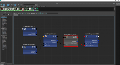

What are the settings on the octaneUVProjection & octaneTransform2D? Are you using UV sets, could Octane be seeing a different UV set than intended? Perhaps you can share the scene for us to look at?
