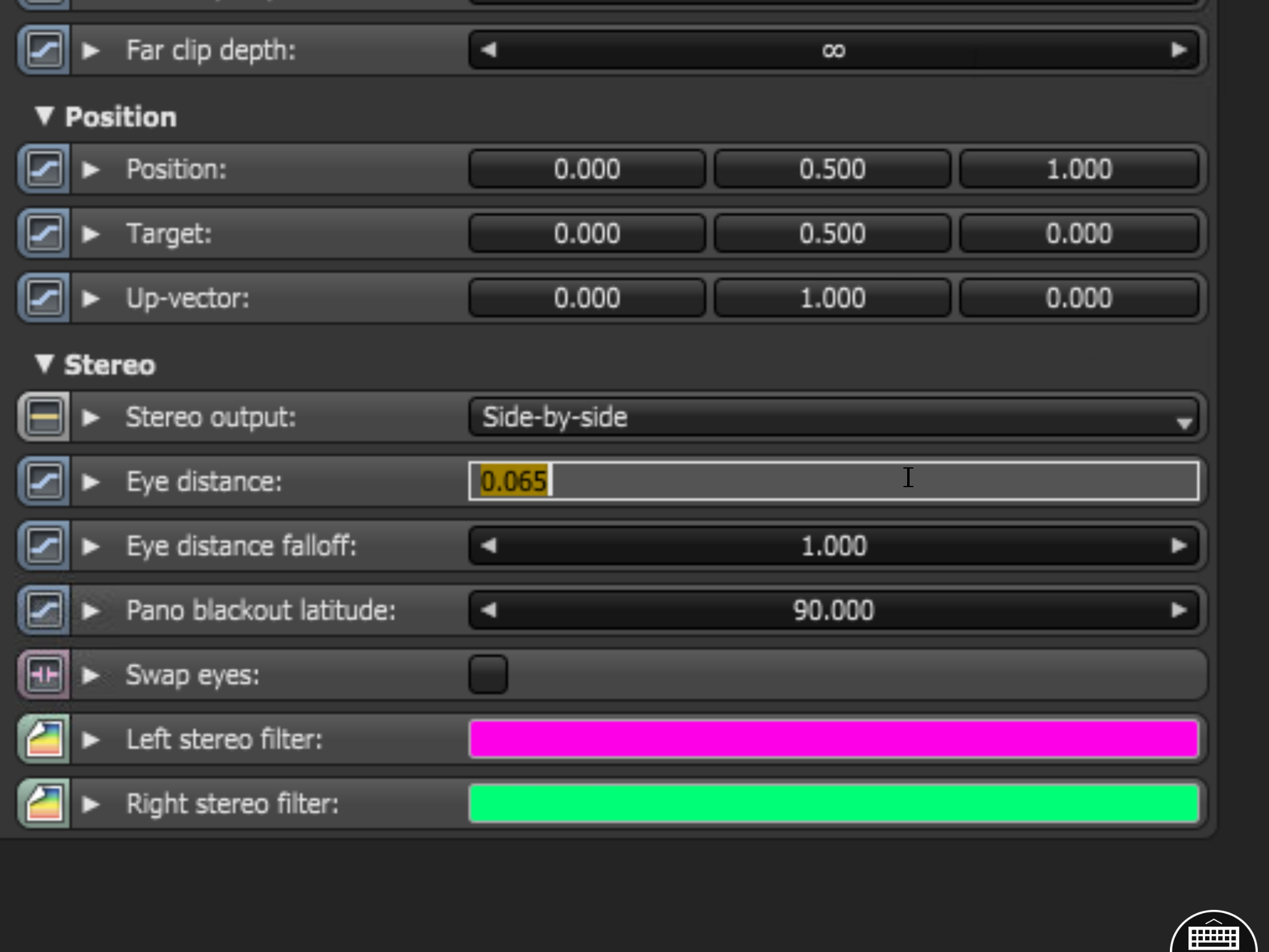

Yes sure, since the vision is splitted for the two eyes, the stereoscopic effect is very good, and you can exasperate or reduce the effect by changing the eye distance value in the camera stereo settings:
ciao beppe
