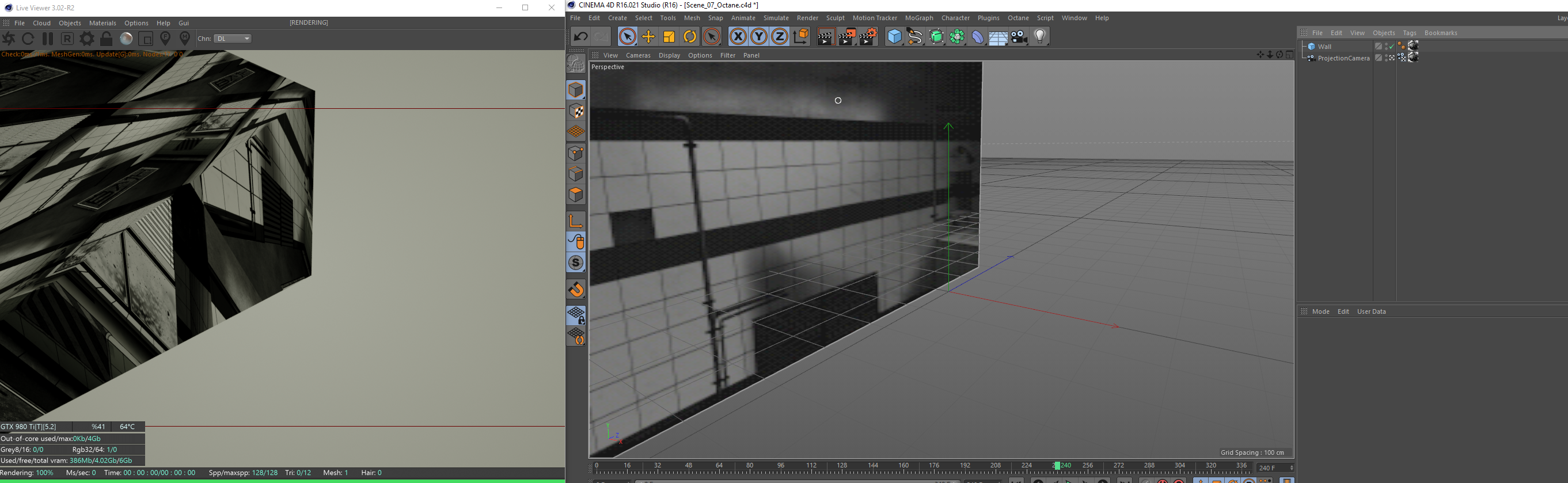

and thanks for your answer. It did solve part of my problem, but the mapping is still off. I do realize it's hard to see on that image, so here is another scene that is having the same issue. Here I only have the camera and a simple shape. As you can see here, the mapping is wrong - I've made sure the aspect ratio values are the same. It seems to work just fine with standard render, but not with Octane for some reason. Really hope you can help me out! Thanks!
Projectfiles: https://we.tl/eN8lq98JpB
Thanks mate!
/Mads
Posts: 10612
Hi Mads,
have a look at this tutorial about Render Layer system, at 2':30" you can find the way to use the octane projection system instead ;)
http://www.vimeo.com/119848103
[vimeo]http://www.vimeo.com/119848103[/vimeo]
ciao beppe

Thank you so much Beppe!
I actually did find the scene files from Aoktar, and managed to figure out how to do it. I am happy to see in the tutorial that you actually have to manually position the projection. Thought I was doing some cheap tricks!
Exactly what I was looking for. Really, really appreciate it man!
