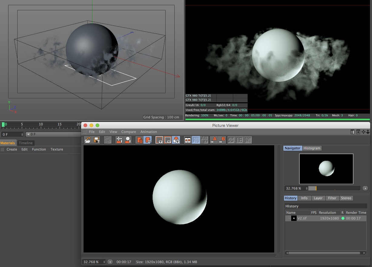

Hi All,
I am having a strange issue!
I place a simple Octane Volume Object in the scene, a standard Octane area light, and set the Volume to a random cloud!
Start the live viewer and everything is perfect! Renders in LiveViewer etc but when I try set the scene to render to PictureViewer (save TIFF sequence)
it shows a black screen? It wont render the Volume object!
Any help would be greatly appreciated!
OSX 10.11.3 | 2xGTX 980TI | C4D R16 | Latest Cuda drivers 7.5.30, and Latest Nvidia Web driver 346.03.05f01
No Volume Object rendering in the Picture Viewer
Thanks in advance.

Solution is to update to latest version. It was a bug on some recent build.
