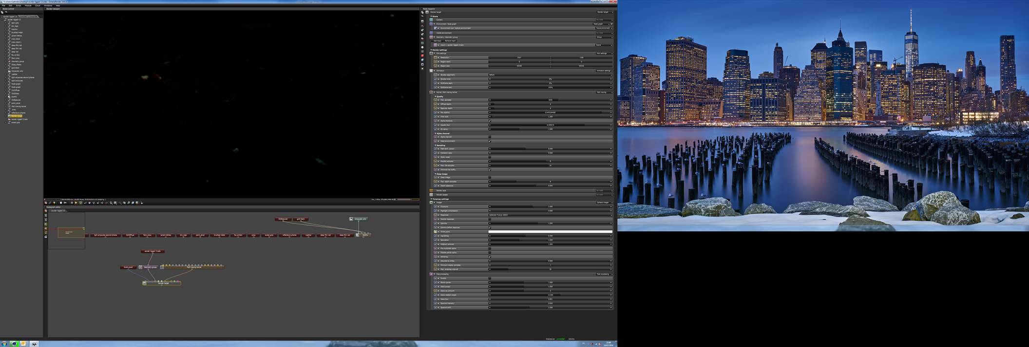

Nope, sorry to say that the Upload Scene Snapshot feature is still broken in 3.03.2, the scene fails if I upload it that way. But I can successfully upload the ORBX file by using the ORC web interface, at least that seems to work now.
Another thing, please put a confirmation popup when you delete something from ORC, I clicked on the trash bin icon of an old scene by mistake, and now it's gone... :(

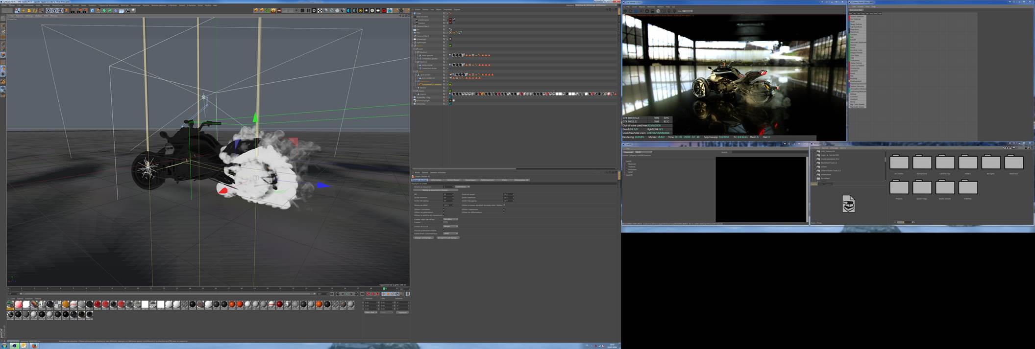

I tried to export this scene from c4d to octane cloud and you can see result.orbx file enclosed.
The result in octane standalone isn't working...

bertritude wrote:Hi,
Soe explanations ?
I don't know reason but this looks like same issue which i notified yesterday. Export is being broken when you have any volume object. Pls try without volume object. If it's fine so that's what i'm saying.

If exporting from C4D to ORBX and rendering that in standalone fails, then that means ORC probably won't render the scene either since it is also running independently of the plug-in and depends on the export process succeeding.
I have not seen reports of C4D->ORBX export not rendering, but if that's the case for you, we need to confirm why this happens and fix that as a first step to getting it rendering on ORC.

Sorry, I must have misunderstood the info Vlad shared with me. If this issue is happening with SE->ORC, but works from an ORBX, then it probably narrows things to the delta updating from Octane core->ORC. Hopefully Vlad can reproduce and fix quickly.

Goldorak wrote: If this issue is happening with SE->ORC, but works from an ORBX, then it probably narrows things to the delta updating from Octane core->ORC. Hopefully Vlad can reproduce and fix quickly.
That's correct, Standalone -> ORC fails, but ORBX -> ORC (through web interface) works.
