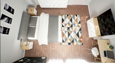

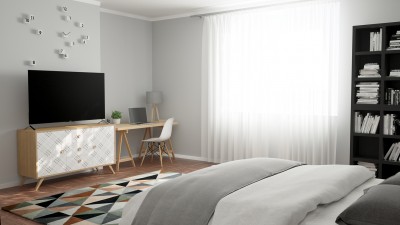

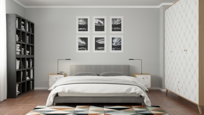

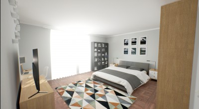

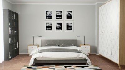

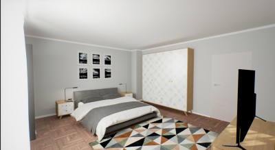

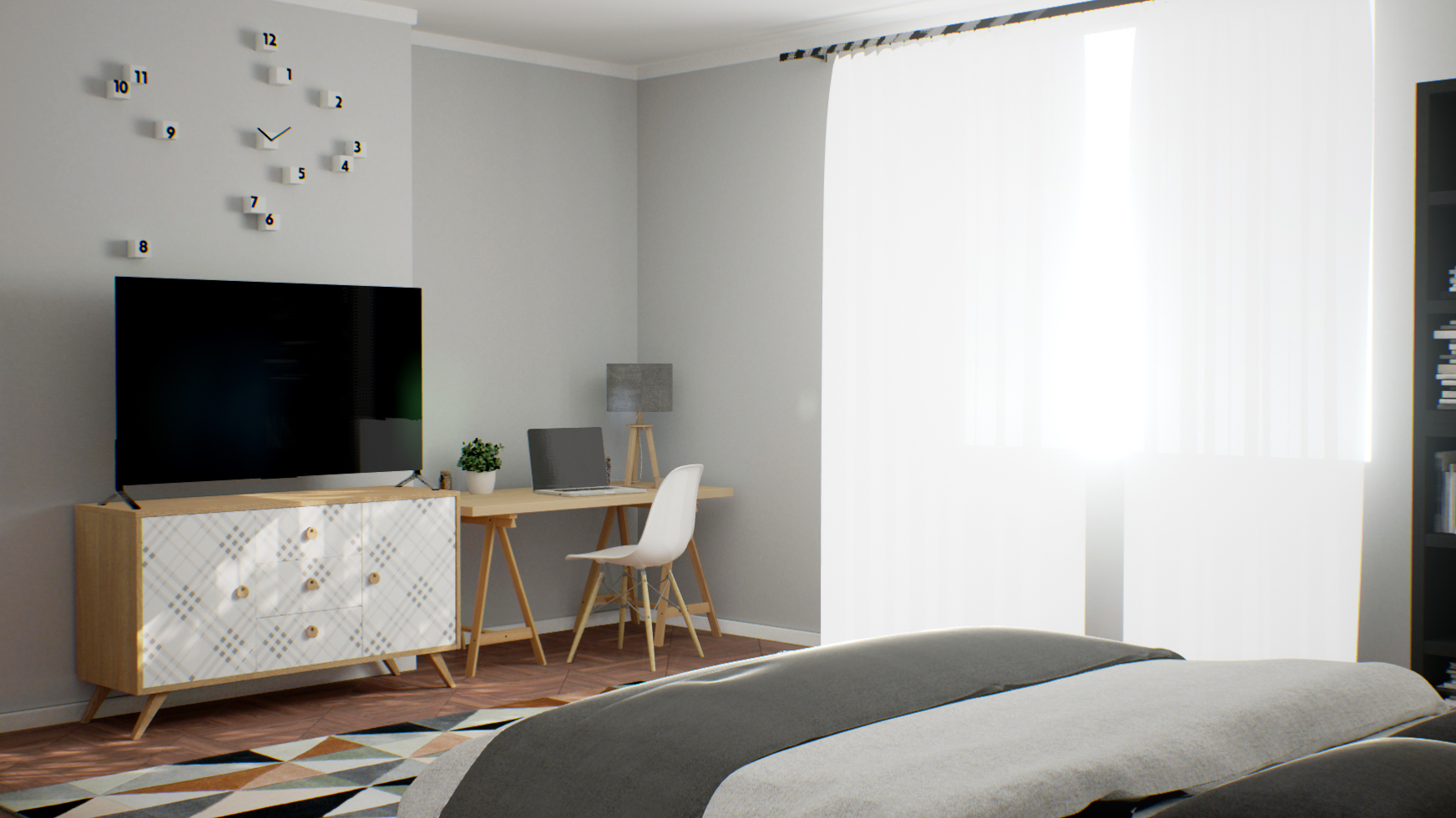

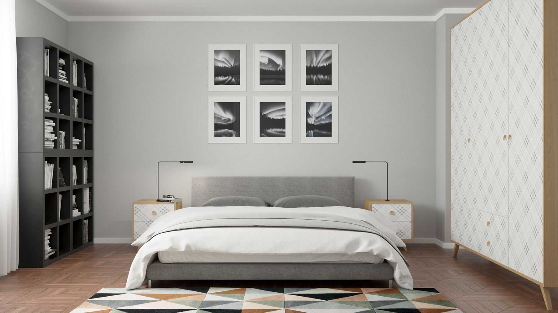

Here are examples directly from Octane render for 3dsmax and baked textures imported in Unreal 4. :D ;)
I must say before this I never used UE4 until now so everything is pretty new to me.
For this scene I baked only diffuse textures, so first in max unwrap everything one by one, then give to every object Baking group ID in Octane object properties from 1 to ...
After that create Octane camera and set to baking and in properties of baking set Group ID of object you want to bake from 1 to ....
This project took me about one week because of learning, but now it probably would take 2-3 days.
Baking was done using PT and textures size vary from 2000x2000 to 6500x6500pixels. :)
I have question for Octane developers is it possible to render in one pass only shadows and lights with transparent background?
So when I import to Unreal I could mix baked shadows+light with regular texture, because for floor or carpet that you saw in video I needed to bake floor,carpet twice, but maybe with shadows+lights transparent pass I could render only once and mix them in UE4 with any regular texture. :D
Baked in octane for 3dsmax - Realtime Unreal 4
Straight from Octane render
