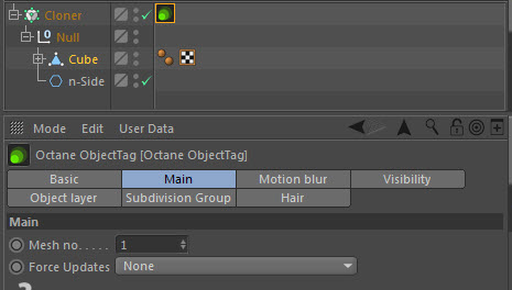

I've been having an issues with the cloner in Octane recently. I've uploaded a file so you can see what I'm talking about but basically parts of an animated cloned object wont update in the live viewer window or when I render them out. Sometimes its just one piece that gets frozen in place or, like the render I did last night, entire chucks will not move. Any help would be appreciated.
Thanks.

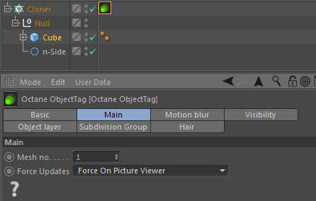

It's about update detection algorithms. Choose one of two ways from images.

Thanks.
All seems to be working now.
