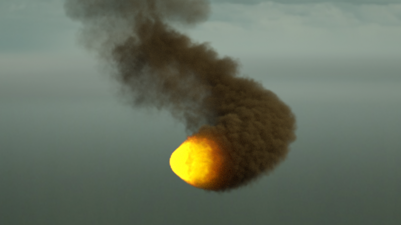

speedracerlo
Posts: 6
Joined: Sat May 14, 2016 7:33 pm
I actually started getting some better results by changing the 'Scattering Phase' from 1.0 to 0
However that was increasing my render time by an incredible amount, so I tried various settings and found 0.5 to be acceptable. Render times are however still a bit slow. I think standard renderer might be faster.

speedracerlo wrote:I actually started getting some better results by changing the 'Scattering Phase' from 1.0 to 0
I have a GTX 980 TI and GTX 970
standard renderer is a standard renderer. Using low "volume step lenght" will make is slower because it increases details and counts of calculated steps.
