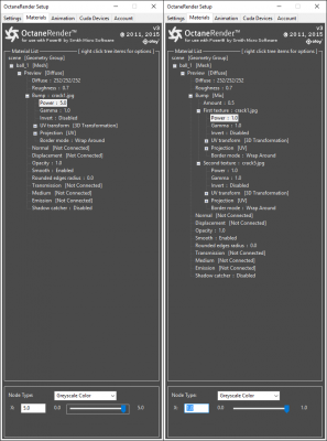

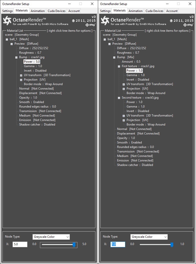

We now can set the Power of Bump up to "5".
Dose this only go for a single Greyscale Images?
I wanted to play around a bit with a Mix Material in the Bump channel, there, the Power went to 1 at max.
Same goes for proc. materials like Marble, Turbulence, Checks ... all go to a max. of 1.
Are there some restrictions (yet?), we have to keep in mind?
face_off
Posts: 15799
Location: Adelaide, Australia
Bump powers > 1 are only supported when the Image node is connected directly to a Bump node.

Aww, pity.
But thanks for the clarification!
