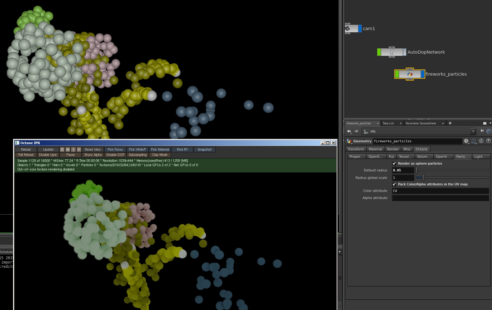

The support of color/alpha attributes in the particles is done
I've add to the plugin an option to pack the color an alpha attributes into the particle UV map. In the plugin there will be a new "tex" folder with the maps that can be used to extract the color information using the texture node, one map for the RGB and other map for the Alpha
-Juanjo
-Juanjo
