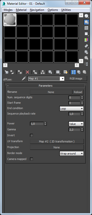

Have you got the "Latest" Test version installed?
viewtopic.php?f=80&t=54886
looks like this:

haha wow!
thats exactly what im looking for.
We are still running OctaneRender_for_3ds_Max_3.0_-_3.14
Wasn't aware there was a new test out. It says "Might be unstabel" But i guess we ain't got no choice at the moment!
Thanks so much for the heads up man! and the quick reply, appreciate it.

The "Test" 4.0 version is working great for our use.
So we skipped the 3.17 version, so no, i haven't tried the scene with that version of the plugin.
