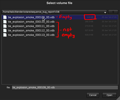

Load the first VDB in the sequence:
and this error occurs:

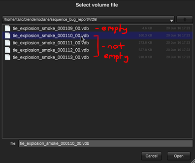

Load second VDB in the sequence:

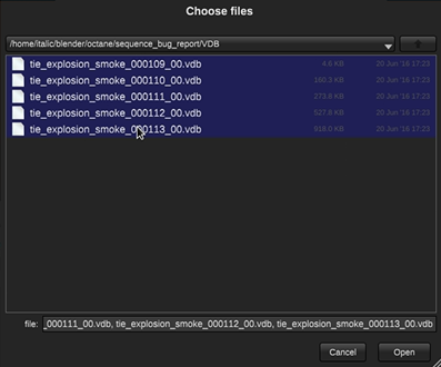

The file loads. Turn it into a sequence with all the VDBs:

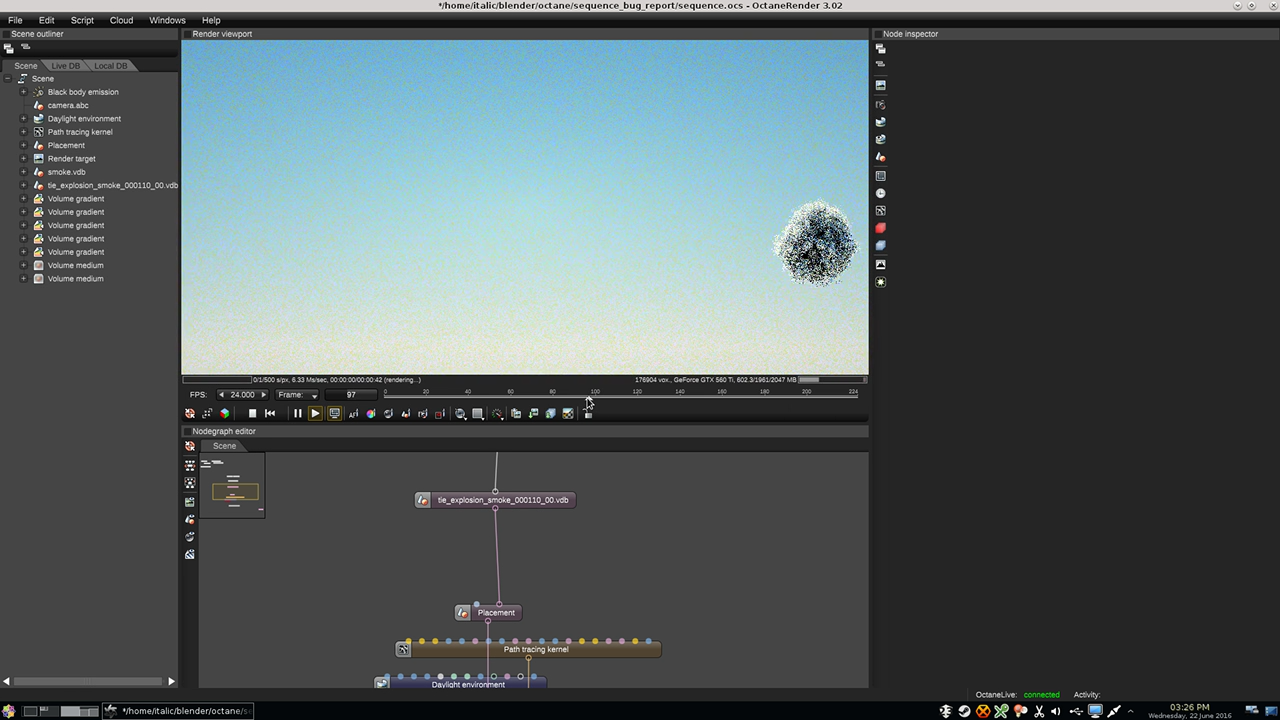

Frames before sequence start display incorrect VDB:

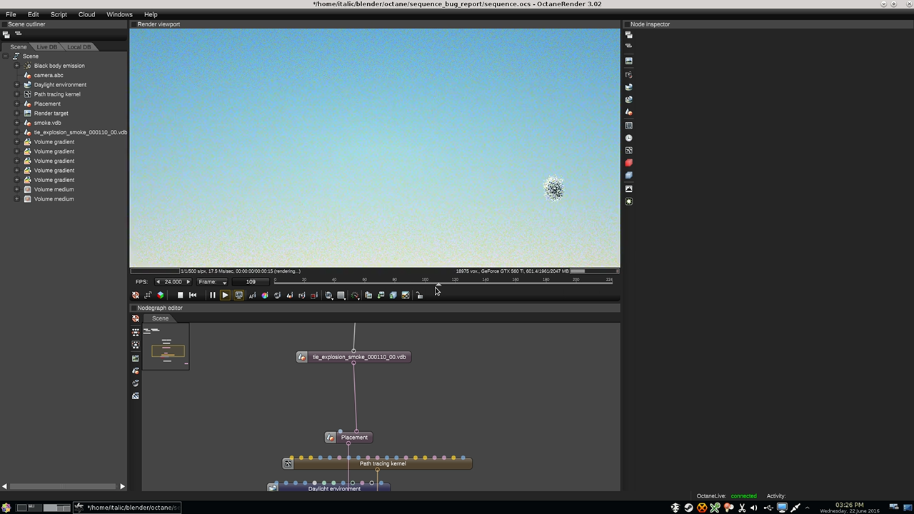

Frames after sequence start display correct VDB:
