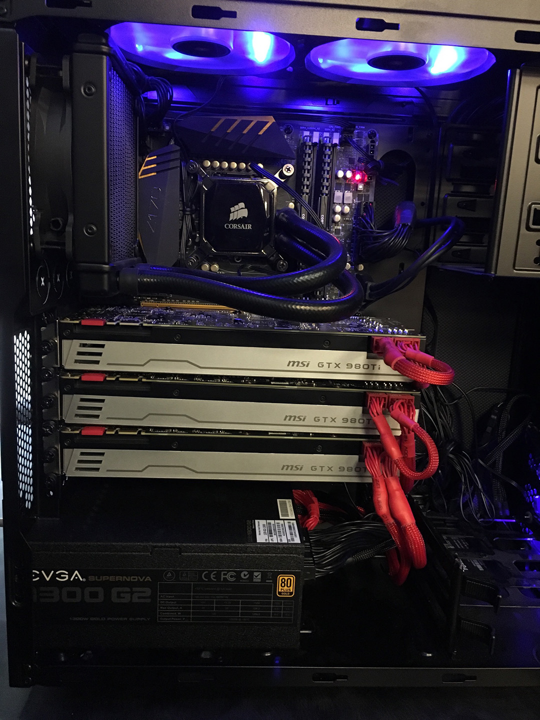

natemac00
Posts: 250
Joined: Mon Feb 22, 2016 3:45 pm
PiotrAdamczyk wrote:Hi,
Have anyone tested 3x gtx 1080 packed close to each other on boards like sabertooth x79? I need to build a new rendernode using spare parts from my old PC and i am thinking about buying 3x 1080 or 3x 980ti. My concern when buying gtx 1080 is that it has not been tested enough and i need stability on my commercial projects. 3x 980ti might get too hot but 2 of them considering how much space would be left between them would be ok. The build will run on air.
I currently run 3x MSI 980Ti's with stock cooling with no issue.
