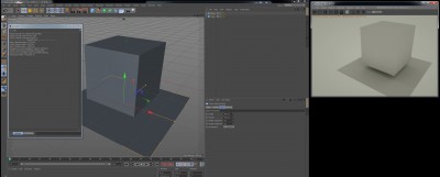

I finally do a fresh install of R17 + Octane 3 but with one of my two stations Octane3 don't work.
First the Standalone work perfectly.
But most of the elements of the octane GUI C4D freeze.
I can open the live viewer and use the Icon menu (thus I can launch the render of the view).
but as soon as i touch the live viewer viewport c4d freeze.
Using the LV menu bar almost all the time cause c4d freeze. Precisely some entry works like Octane daylight but most not.

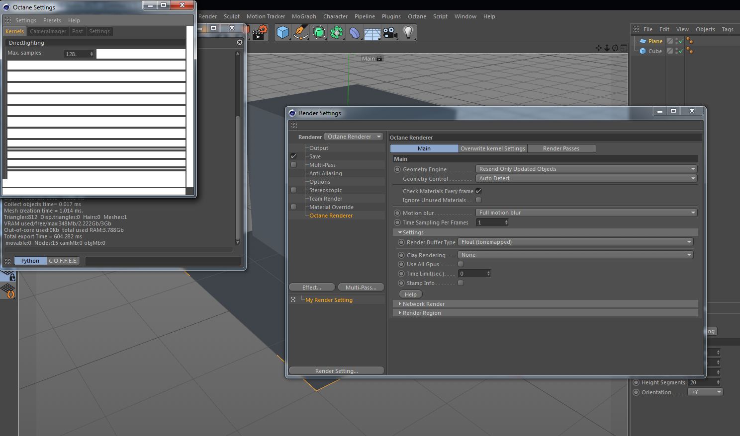

Open Octane Dialog or Octane Setting windows same thing.
On the other hand i can do a render with the picture viewer.
and I can manipulate the view with the C4D viewport. While i don't try to LiveViewer Work.

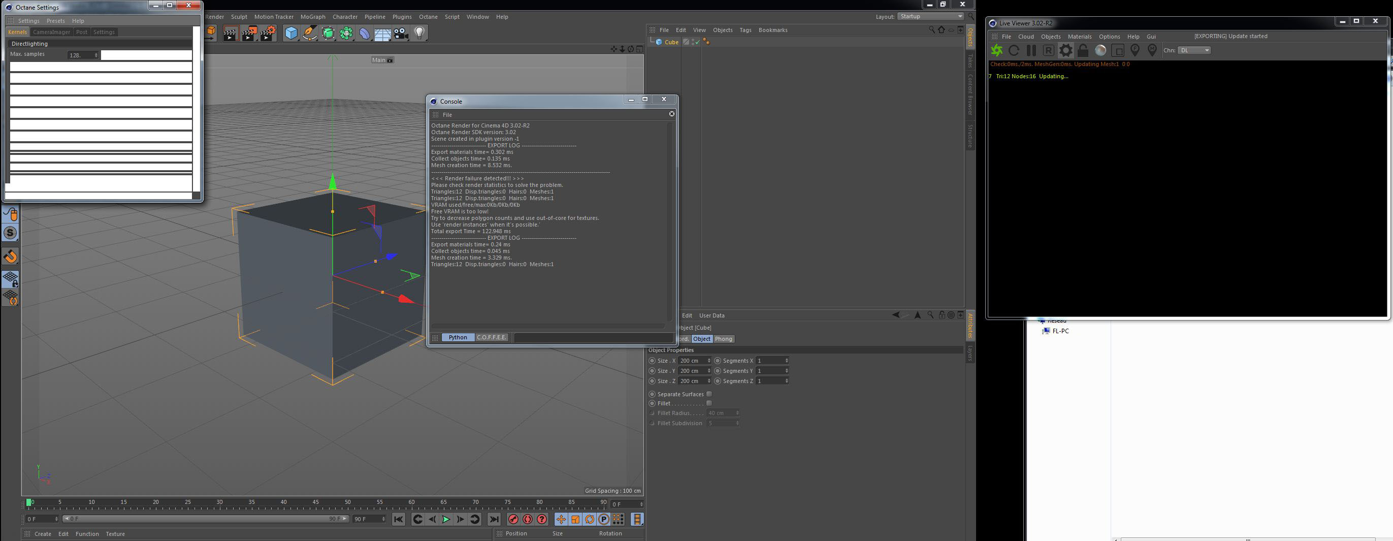

I join a capture with just the C4D console since I can't open the Octane console.
and another where you can see what's happen if I try to open the settings windows
