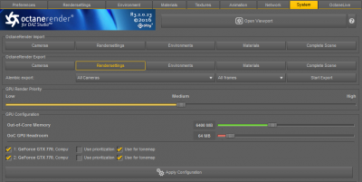

Where do I set this up within the plugin? I can't seem to find that option.

Rik56 wrote:Where do I set this up within the plugin? I can't seem to find that option.
Under the System tab.
