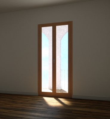

Hello everyone, I have a problem with a rendering. In the exterior of this scene form of artifacts. a thing it had never happened !!! The lighting comes from a HDR image. how I can alleviate the problem?

Are the artifacts the dirt on the door glass? I am not sure. Can you send to me the scene to test it here?
One thing you can test is to modify the ray epsilon parameter in the kernel, to know if you have a precision issue.

Thanks Juan, is not dirty !!! I send you the scene.

The problem is the quad light "finestra" that you have behind the window. It has a shape opacity of 3%, and this is what is rendering the artifacts. If you set the shape opacity to 0%, or you enable the unseen by camera flag, the artifacts should disappear.

Thanks a lot Juan, you're a real war machine!!!! We should make a monument!!!
