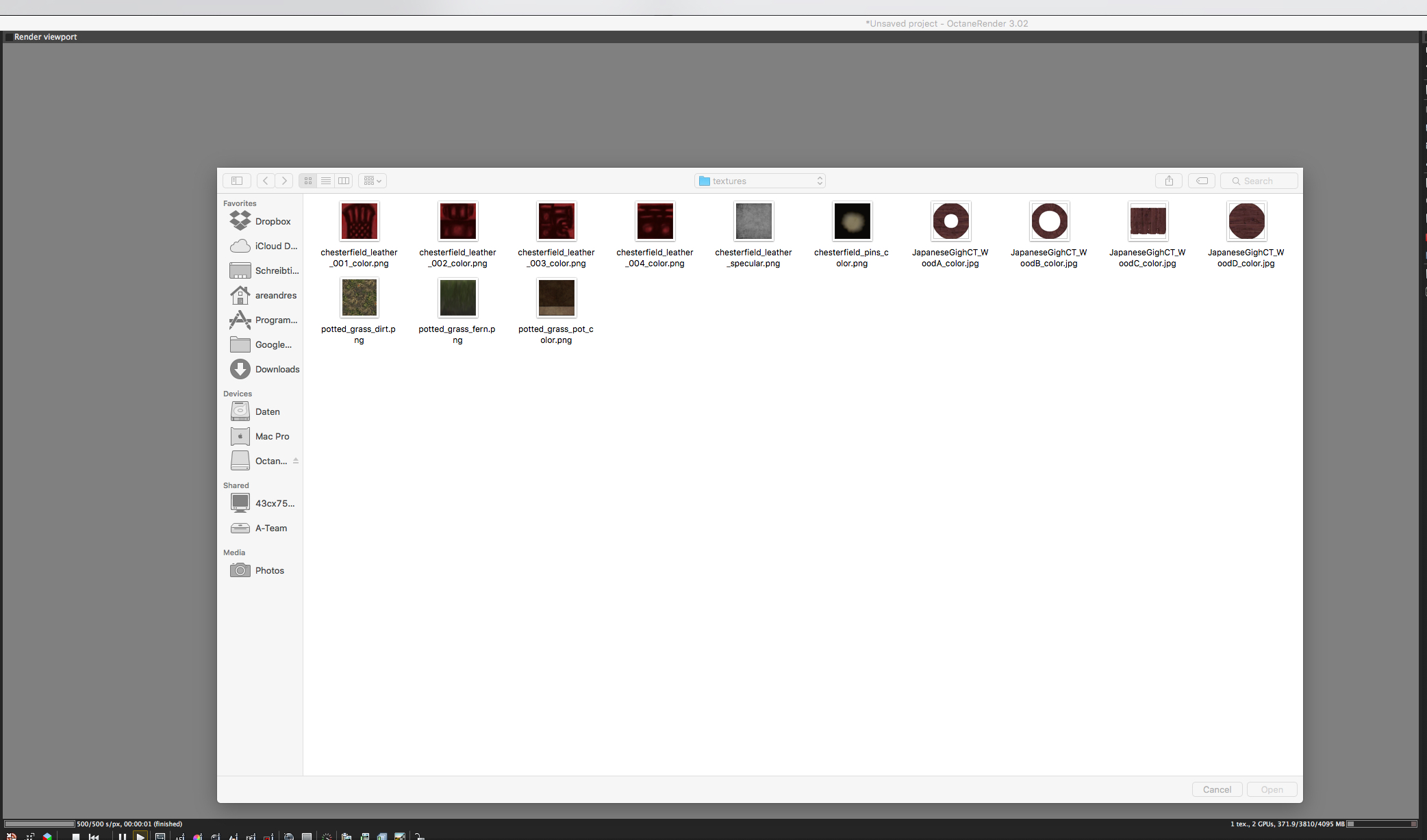

When i export a scene (including textures)from Blender to obj.
Then i import the obj scene in octane standalone.
Then some pop up comes (you can find attached) there i need to choose (i think textures)
but i dont know what i have to choose.
Is there a way to know what octane wants ?
In blender it is easy when there is something missing then you can see what i need to choose.
Greets Andy

Hi Areandres,
I guess you are on osx 10.11, right?
Unfortunately is related to osx, but you can overcome this limitation if you go to Preferences/Application and untick the "use native file dialog" option. A new opening window with octane gui will be open with all the necessary informations in the top title

Hey beppe,
thanks a lot.
Now it is working. The option was on native mode.
