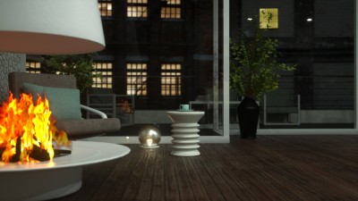

I think you should describe what you're trying to do first...
Image resolution... bigger = slower
For me, the biggest issue is using specular materials for glass in windows. I fake that out and the render settles fast. (I use a fake reflective glass.)
I don't generally work with HDRI, but sometimes I'll use environment for lighting. Where possible I avoid both of those and fake it out. I'll place a giant emitter to simulate sky lighting a scene.
This is a render of a room with fake (pure glossy) glass, and fake sky.  In HD it took 45 minutes to render with only one of my GPUs.

Nicely lit scene Hydra. Did you render using direct lighting, path tracing or pmc? I'm trying to light an indoor office scene as naturalistically as possible. Using HDRI and emitters works well in path tracing but the lower the specular and diffuse levels the less realistic it looks and the faster it renders. The fake glass is an interesting idea but I'm not sure how to achieve that.

I used Path Tracing for pretty much everything.
Here's my fake glass;
