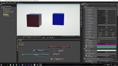

- open scene 01

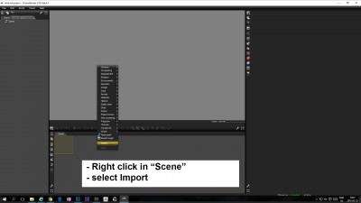

- right click in Node Graph Editor

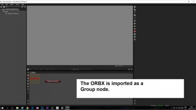

- import scene 02
- add geometry group node between render target and geometry of scene 01
- add placement node between geometry of scene 02 and geometry group node if needed

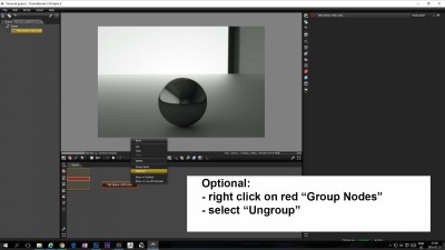

If the imported scene is in a grouped state
- right click "ungroup"

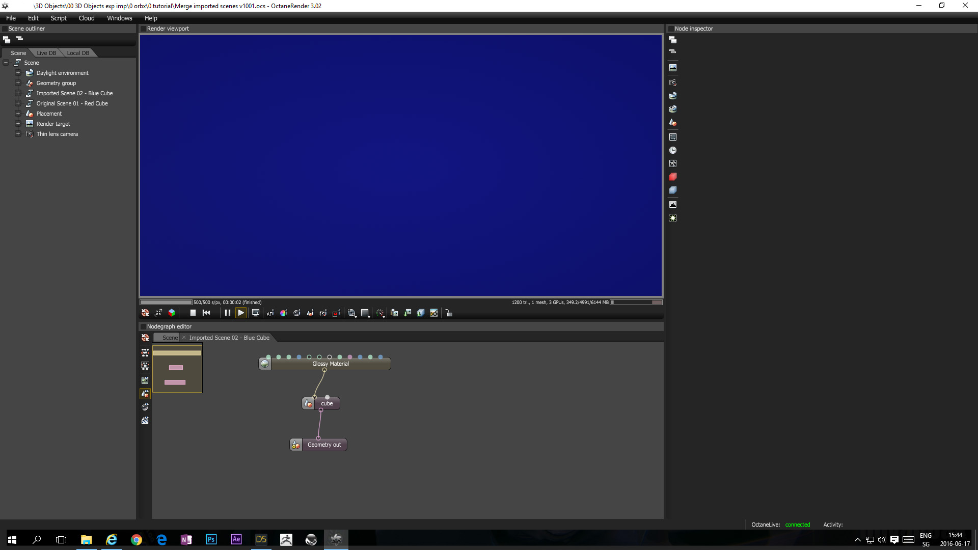

or alternatively
- add a "geometry out" node and link it to the geometry of scene 02
