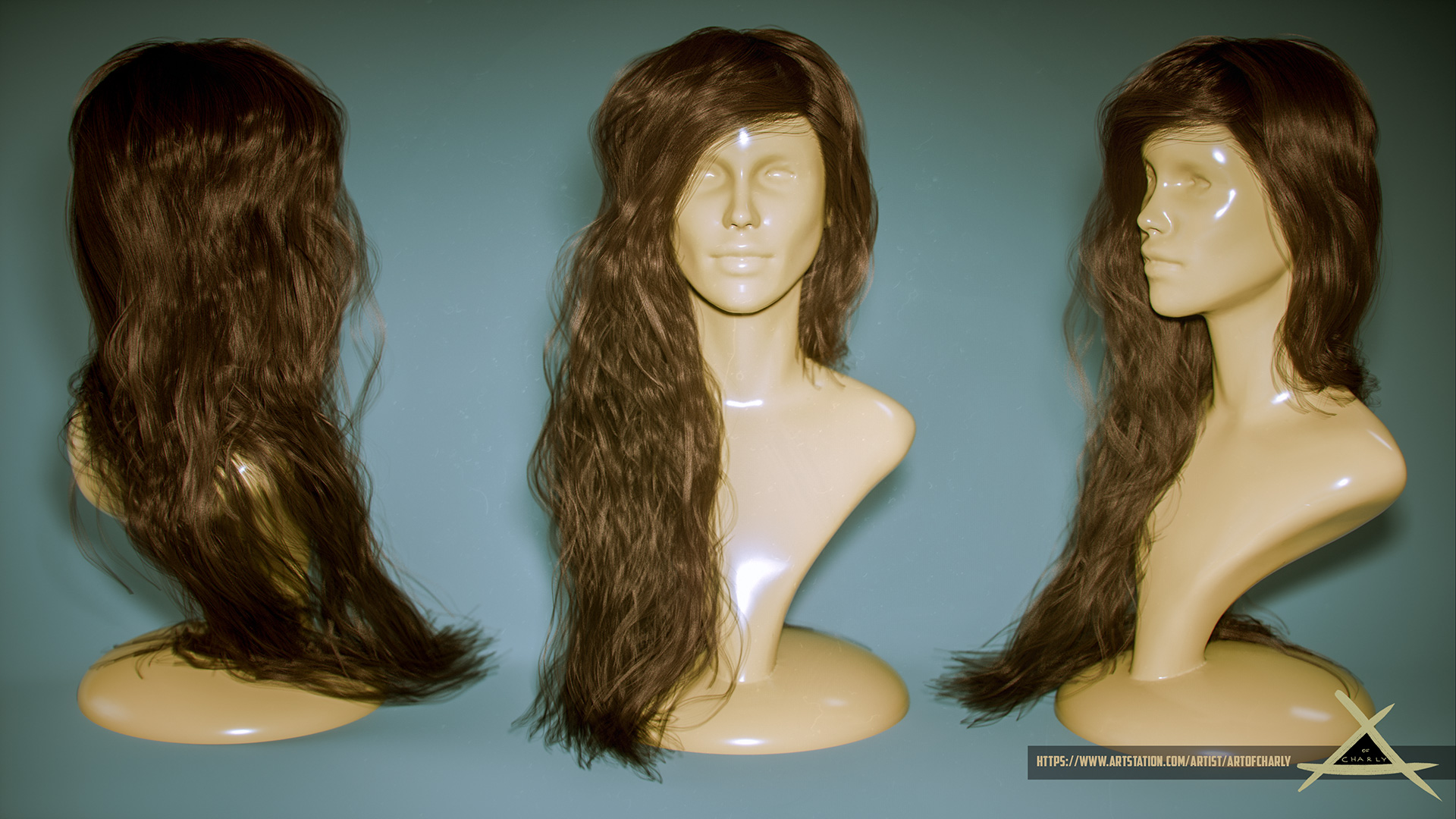

I uploaded in the online hair shader . organic , skin, realistic hairRectro33 wrote:Hi.
I'm a C4D user, and am demoing Octane. I'm realy interested in making realistic human renders, and want to know how good Octane is for Skin, and hair rendering.
Iv seen there is a material TonySculpture I think that's the name, but as a demo user cant get access to it. I'm at a loss at the moment as I can only evaluate what others have done. Octane looks more complicated than other render solutions like vray.
Are all materials made in all platforms compatible so if I found a material created from Maya will it work in C4D?
Another question regarding a decent setup for rendering animations. I have 1 single GXT 780 6GB card, seems quite fast, would a GTX 1080 when its fully supported going to make that much difference?
Dan
viewtopic.php?f=5&t=54448
