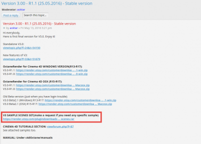

Please check samples.
viewtopic.php?f=85&t=53989

I didn't find any solution to this from the samples. I see the colored cones, but I would like to be able to see the spheres in editor and in preview window
Please show what you get or can't. Also post your scene and describe what you're trying to get.

Please see: viewtopic.php?f=25&t=54776#p279542
I wrote above to check sample scenes: viewtopic.php?f=85&t=53989
Of course this is fastest method for accessing to particle data. May be faster 10-20 times haven't measured. But much faster due elimination of the all extra processes.
