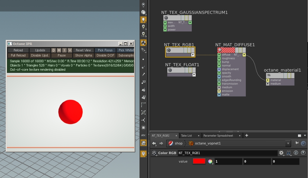

HI, As far as I can tell I have 2 node that dont work - NT TEX RGB, and TEX Float - they appear empty with no output connections - see pic
Please advise?

Yes, the output type seems wrong in these two nodes. They work, but the output type is undefined.
I'll check it for the next build. Thanks for reporting!

This problem has been fixed for the next build.
