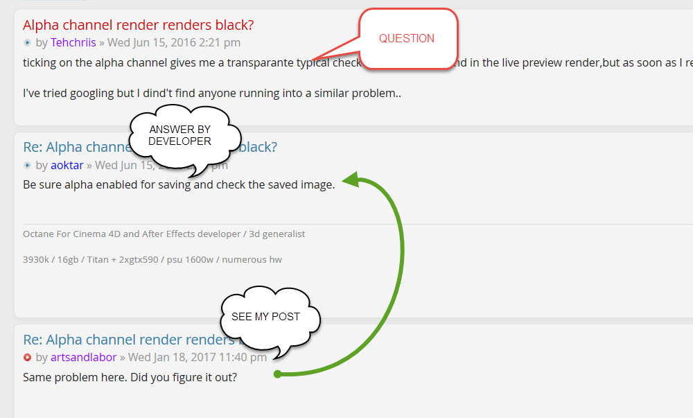

ticking on the alpha channel gives me a transparante typical checkerboard background in the live preview render,but as soon as I render it out to the picture viewer it all gets a black non transparant background.
I've tried googling but I dind't find anyone running into a similar problem..

Be sure alpha enabled for saving and check the saved image.

Same problem here. Did you figure it out?
