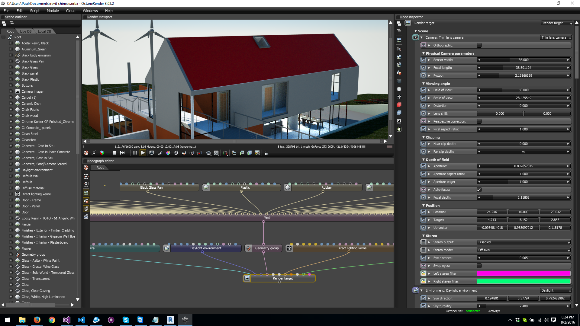

I did a quick test...
1) Set the startup command to "C:\Program Files\Autodesk\Revit 2017\Revit.exe" /language CHS
2) Loaded the rac_sample_basic_project
3) Started rendering with the Octane plugin
4) Exported to ORBX
5) Loaded the ORBX into Octane Standalone
All materials were loaded into Standalone correctly. Pls see below.
Paul
