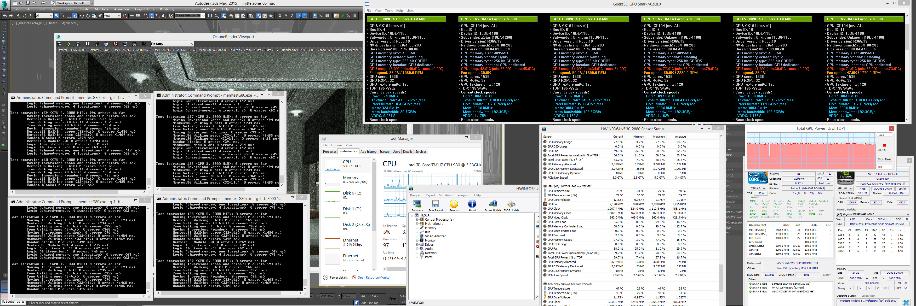

I need to get my sheet completed with octane's numbers:
Bus ID 04 - gpu shark: 1 - HWinfo: 0 - memtestG80: 0
Bus ID 05 - gpu shark: 2 - HWinfo: 1 - memtestG80: 1
Bus ID 06 - gpu shark: 3 - HWinfo: 2 - memtestG80: 2
Bus ID 07 - gpu shark: 4 - HWinfo: 3 - memtestG80: 4
Bus ID 10 - gpu shark: 5 - HWinfo: 4 - memtestG80: 5
Bus ID 11 - gpu shark: 6 - HWinfo: 5 - memtestG80: 3
trying to trigger the render failed with isolated card rendering while memtesting the other 4 to get the surrounding temperature...

mojave wrote:As an option you could use the standalone version and disable all GPUs but one (go to File > Preferences > Devices) until you find the one causing the issue.
tnx mojave but this is what I basically was doing: letting octane render with ONE gpu while stress testing the other four (to simulate the heat that would occur when rendering with all gpus.
anyway the memtest reported some errors writing random blocks on two of the surrounding cards.
NOW two weeks ago I installed NVIDIA driver 365.19 for being able to test octane 3.
after reverting the driver back to 347.25 the problems seem have to be disappeared: just reached 12500 passes at 5200x3200 resolution after 15 hours of rendering with ALL gpus WITHOUT render failed warning.
so beware of that driver..
