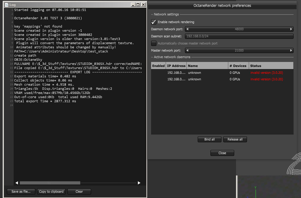

I feel that this version 3.01 test3 does not work with network rendering here ?
I may be missing something :(
Anyway, if anyone can post an example of "material stacking" I do not know how make it work ? thanks in advance ;)

pxlntwrk wrote: Hi,
It doesn't match the Standalone versions.
Yes i saw that,
But I am not able to find 3.01 Standalone or the good one ?
pxlntwrk.net
Posts: 16063
Location: Türkiye
pxlntwrk wrote:
Yes i saw that,
It's based on a test SDK. I'll make a new release based on previous SDK(3.00).
