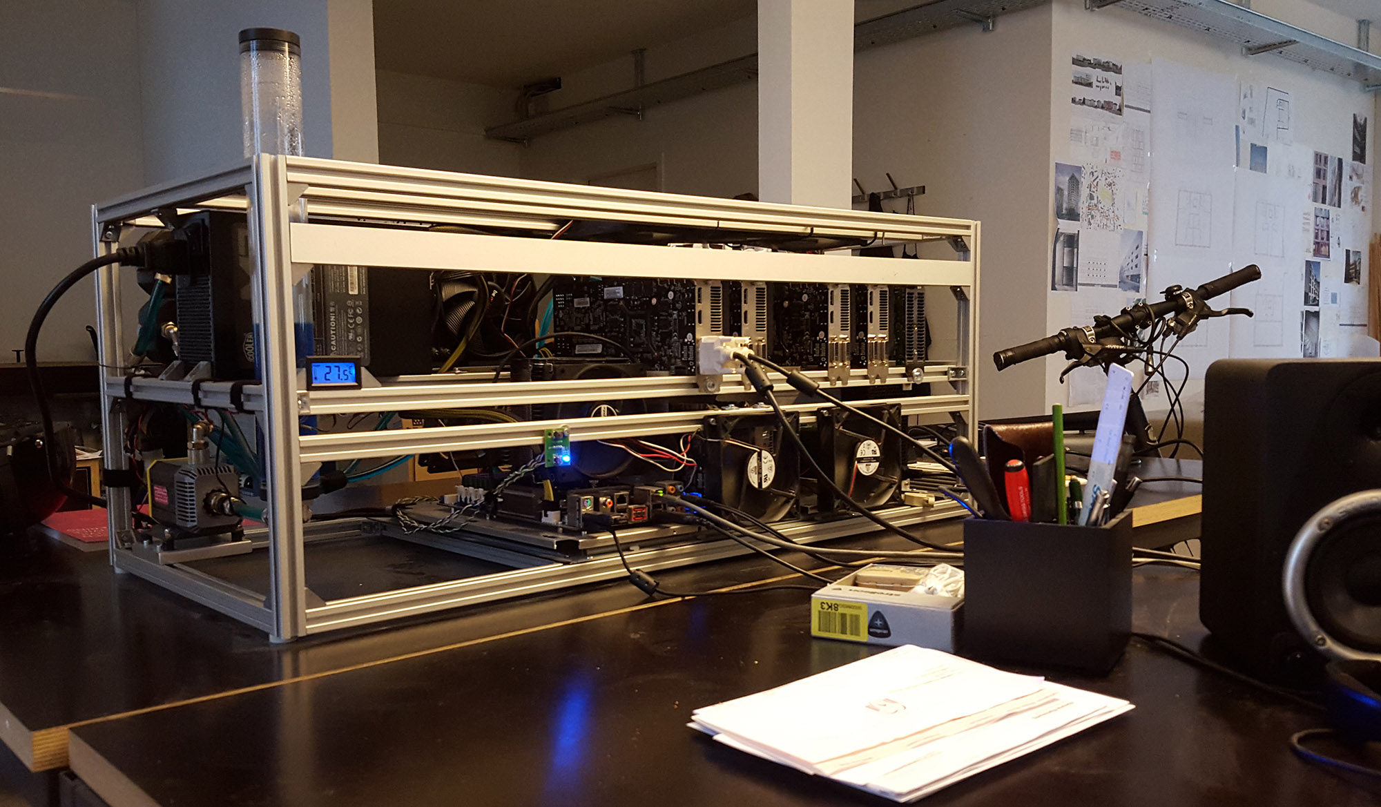

My current working computer is and open structure rig with 1 dedicated and 6 GPUs for rendering. 5 of the GPUs are raised with PCI riser cables. The cards have many space to run cool.
This setup has mostly worked very well in the past 3 years.

edit: for those interested what this looks like:
P6T7 WS SuperComputer / i7 980 @ 3.33GHz / 24 GB / 1500W + 1200W PSUs / 6x GTX 680 4 GB + 1x Tesla M2070 6GB (placeholder :))

boris wrote:5 of the GPUs are raised with PCI riser cables.
Long cables may be not so robust as when the card is directly in the slot... Perhaps some data loss from time to time may occur...
boris wrote:The cards have many space to run cool.
You know, even with enough space for aircooled cards... I always disassembled my cards right after buying - and always the stock thermal connection between chips and a cooler was just a joke. I always removed a stock compound, cleaned the surfaces, and put a thin layer of good silver compound there...
The GPU may fail even if the temperature of GPU chip shows up as OK. E.g. the mosfets in power module having bad thermal connection to a cooler may get so hot that you could get burn from them... That affects the quality of power supply of the GPU board. Or a memory chips may get overheated too...

Could you please let me know what is the framing you used there. Where did you buy it?
Which brand / make risers are you using right now?
thanks

tnx.. these are standard 20mm aluminium rods, there are different types of it, mine is bosch if I remember correctly. I bought in a shop in germany since I live in switzerland and in switzerland those things are just double the price..
I planned the thing in autocad, placed an order and the hardware shop in germany cut it to the right length. price was about 350$ with all the nuts, screws and L-type parts.
assembly took me one day or so.
the good thing is it's very flexible.

the four gtx680 are the gainward type and this is a very good cooler IMO (at the cost of 2.5 pci slots).
the 2 cards on the mainboard are water cooled but this is a relict from my previous system..
the riser cables I found on ebay from a firm liquidation. they are 12cm long. will give you details when I find time.. 2 of them are stacked...
have to go, give you some more details later if you wish.

edit: tracked down the riser cables: type is CLKF731 / CLKF731S1
the cable itself is covered with a kind of silver pad which should ensure no speed loss.
http://www.sintech.cn/riser%20card/ST-C ... cable.html
