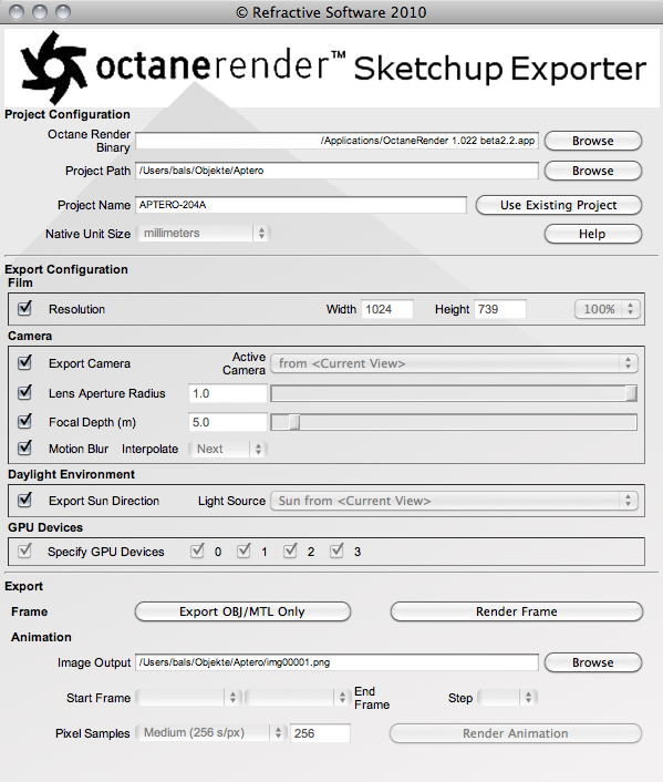

MAC users only - can you please try this new test html file
OctaneDialog-html.zip
(2.75 KiB) Downloaded 328 times
Extract it from this zip file and use it to replace the equivalent file in the ../Plugins/Octane/ folder.
I am hopeful that it might at last allow the MAC version dialog's check-box values to populate correctly with the defaults for a new SKP [most off except camera] or preset values on a SKP that has previously used the tool and been saved/reopened... I found some omissions in my edit which don't affect PC users but might affect the MAC...
If this works I'll prepare a new full version issue for all users...
Feedback please...
TIG
Burkhard
Posts: 142
Joined: Mon Jan 25, 2010 7:53 pm
Nothings changed. All are checked as before.
MacPro Quad * 8Gig RAM * GTX 285 Mac Edition ( delete two GT120 to make it run with octane! ) * Snow Leopard 10.6
