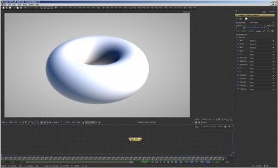

Are you using the multi-layered EXR files feature? Perhaps After Effects has some problems with it. In Fusion the multi-layered file is working file, but perhaps in AE there is some kind of problem. Can you please test the not multi-layered EXR file output?
