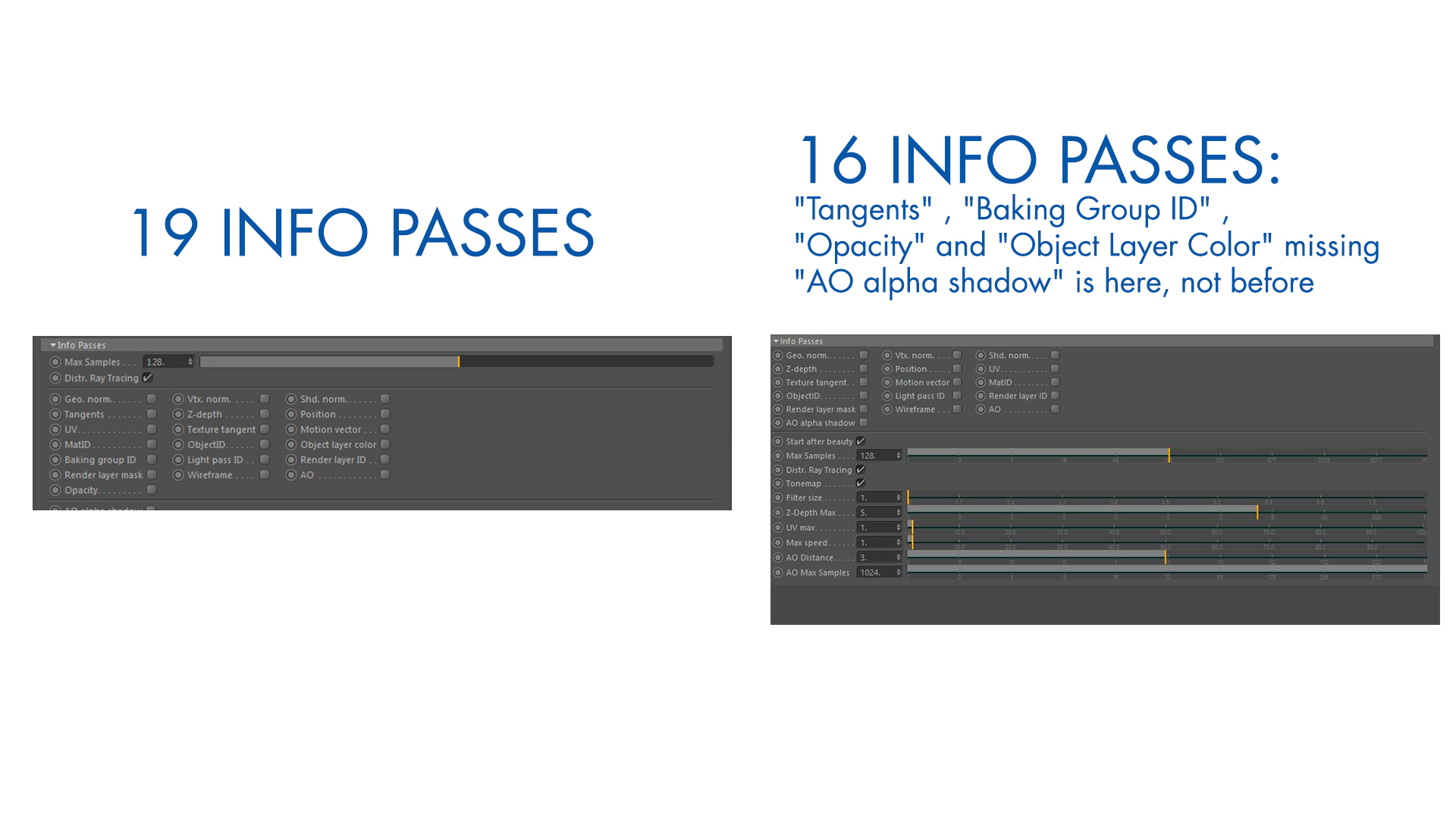

Since i've updated Octane from 3 BETA to 3.00 R1.1, some of the info passes have disappeared from the Render Settings Window.
For exemple, the "Object layer color" pass is not there anymore. But if i open an old project created with 3 BETA version with this pass activated, it still render correctly, even if the option is not accessible anymore.
Here is a screenshot of the issue ( screen from a friend on the left, screen from my computer on the right )
Any idea there ??
Info passes have disappeared...
Check your install. Associated files are in res folder. They should be correct. Also check Console output when you loaded Cinema 4D. It should print out correct version numbers.

Thanks Aoktar
I found the issue. I'm not an expert but i think it was a problem with permissions on the octane plug in folder.
I ran C4D in administrator mode , and everything is back to normal now.
Thanks !
