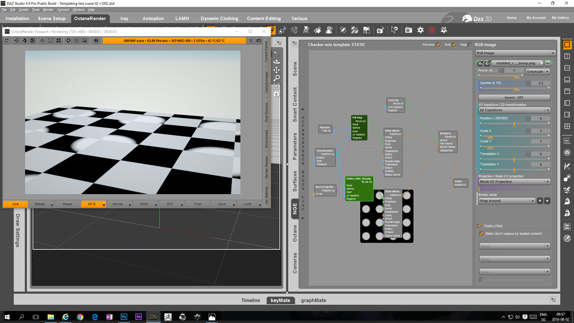

Test scene 02
- plane with
mix material
Material 1 template diffuse map
Material 2 template diffuse map with Static (don't replace by loaded content) activated
checks mix
Scene 02 Material 2 templating STATIC dont replace with loaded content

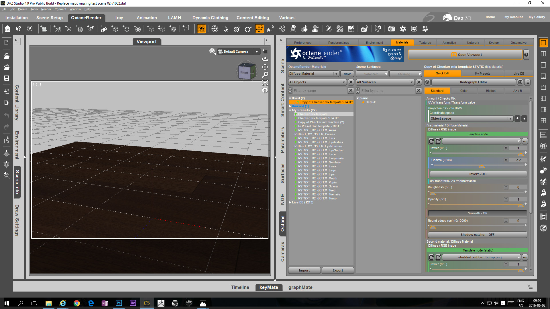

- save this template setup as a user preset
- create a new scene with a plane with a different diffuse map in the DAZ Studio materials applied
- autoconvert the scene (maybe needed to load the maps into OcDS memory)
- now add your user preset with the checks mix pattern that has STATIC active
Scene 02 user preset with STATIC templating applied
- right click to use "Replace all active maps"
Scene 02 Replace all active maps
-> End result:
Now the image looks as expected.
- The templated node of material 1 was updated with the new diffuse map from the DAZ Studio surface zone
- The templated node of material 2 that was set to static remained and was not updated.
