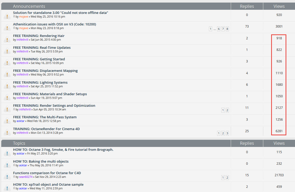

I'm asking because many people ignores the video tutorials, it mostly cover nearly all options. When i asked that they generally says that don't know it. I'm trying to decrease my spent time on support to able work on plugin much more.
Do you see this view counters? They are here since one year or more.
