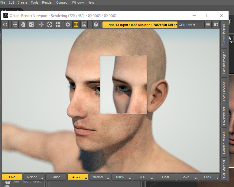

I do not believe that region render is working properly.
STR:
Start a render
Use the region render/spot render feature in OcDS
Observe regions outside of selected area resolving at the same rate as the selected area
Seems like the entire image is resolving at the same rate, not just the nearby tiles or anything focused.
Win10 x64
i9 10900k 64GB
2080S 8GB
DS 4.15 OcDS Prime ^_^

larsmidnatt wrote:I do not believe that region render is working properly.
STR:
Start a render
I was not able to reproduce this with
Daz Studio Pro BETA - version 4.9.2.70
OcDS 3.0.20.22
Make sure to use the Region Rendering tool located in the OcDS viewport.
Using the DAZ Studio "Spot rendering tool" will not have any effect.
For testing try again with PMC mode and extremely large dimension values like 6000x4000 to better observe the effect.
Quick OcDS Region Rendering guide:
viewtopic.php?f=44&t=54401

@Lin, yeah I know how region render works, been using it a long time. It just stopped working for me in 3.0 test. Hence me specifically saying the OcDS plugin. I didn't have this problem in 2.x. Only reason I said spot render is cause I couldn't remember which phrase was used for OcDS :) I use em interchangeably.
Resolution isn't the issue, I thought because of the new tile rendering that may have been the reason, but not so much. And you shouldn't need PMC mode, I rarely use that. PT is fabulous for most scenarios.
Thanks though.
If it happens to be 4.8 specific, that sucks because I really use the region render a lot. I can prove it doesn't work very easily
STR:
Load character
Set region render area around head
change character shape/height dramatically
ER: Region render would only update head area
AR: Entire frame is redrawn to match changes
It flat out doesn't work.

STR:
Start a render
I could not re-produce any issues with the Render Region functionality on the next release of plugin. So I suggest you re-test it on the next release once it's posted in the next couple of days.
