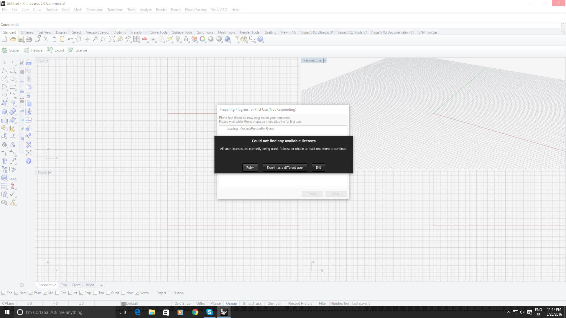

here is the error message i got. I'm using octane on 2 computer but never on the same time (home & Office).
the error message
the error message

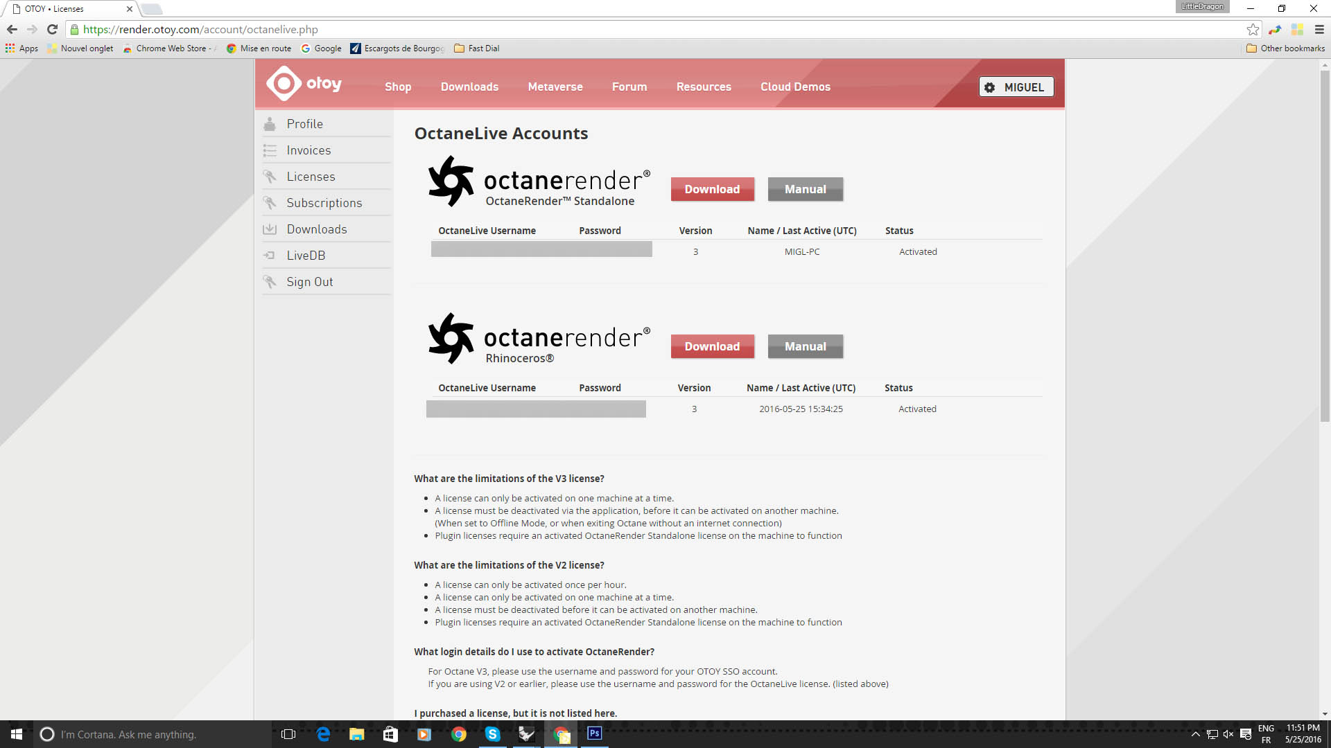

Here is my status page from the licence status.
mojave
Posts: 1336
Joined: Sun Feb 08, 2015 10:35 pm
nohyim wrote:Here is my status page from the licence status.
When you see 'Activated' on the licenses web UI means that those licenses are in use.
Looking at your screenshot I can see your Rhino license is been activated with a plugin corresponding to V2 (I know as you can see the date but not the hostname ;) ).
At the moment you'll need to deactivate that one manually (reverting to the old plugin version) but we hope to provide a way to do so via the web UI.
Sorry for the inconvenience.
