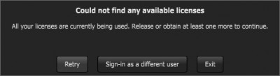

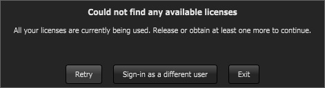

eightvfx
Posts: 40
Joined: Thu Jun 26, 2014 6:36 pm
Hello !
> login with 3 beta 2 works fine with stand alone and plugin,
but > for 3 release >> impossible to login with same login information.
thanks.
Posts: 16067
Location: Türkiye
eightvfx wrote:Hello !
thanks.
Open V2/V3 standalone. Make sign-out from account section. try again.
eightvfx
Posts: 40
I uninstalled v3 release,
> did install v3 beta2 and started the standalone to sign out from it.
> uninstalled it.
reboot.
install again v3 release.
and still this error message.
