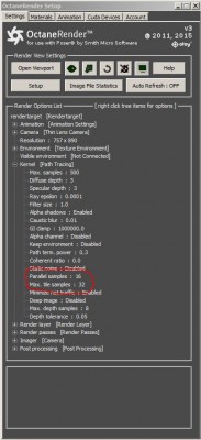

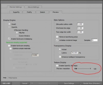

In your Kernel you can try to set Parallel Samples and Max Tile Samples to 1. It will slow down the rendering speed but free up Vram. You can also free up more Vram by turning down Preview textures to 128. In big scenes this can really free up some Vram.
Thanks for this information, I was aware of the Windows 10 issue with eating up the VRAM, with the out of core textures on this was worked around but still annoying. I can imagine Octane 3 would use more VRAM but surely with the out of core textures and it telling me I have memory available it would still try and render. I did try reducing parallel samples to 4 from 8 but will try reducing it to 1, but if this makes it a lot slower seems no point to update yet to v3. Didn't know about the previews textures will give this try as it's a very useful tip.
