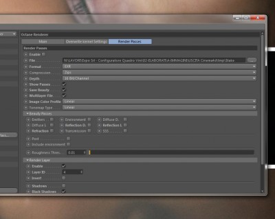

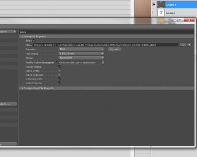

you have just to set in render settings as Save Tab file, some variables like:
$take: that read the name of the take list and put it as folder name or file name, etc.
$rs: Current Render Setting name
etc.
very useful if you have to generate a lot of images (like for a configurator f.example).
It seems to work from the Cinema4d Save file tab name, but not from Octane Renderer passes Tab
R17 Take System and Octane Render Settings Path

Thanks! Added to my list. I'll check for possibility. Problem is we use custom gui and functions for some file operations. I hope that's possible to inject.
Not yet. Try C4D's multi-pass saving route.

Not broken. It's not implemented. Use C4D's native image save sections if you need. I'll not add this functionality on passes in any short time. It's not easy or possible atm.josephfagan wrote:Is the Take system still broken with Octane 3.0? If so any idea when this functionality will be compatible with Octane? As the Take system is the closest thing C4D has to Maya's render layers It is necessary for our team to use.
