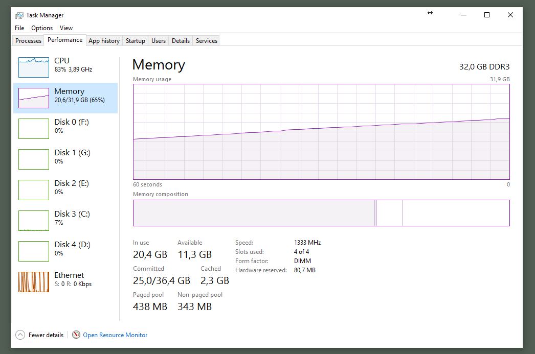

If I render this scene in Live viewer the ram looks like this:
And it keeps rising until the crash. And if I delete Oct camera tag, it works fine, or if I delete the Loft mesh, it works fine, only if both are present this happens.

some update on this matter, it looks like the problem is I was going back and forth between v2 and v3 with the scene, and I was using a camera tag in v2 that was set to baking in v3, but since v2 has no baking it worked like thinlens, and now when I opened it back in new v3 it recognized baking setting again...
So I guess my machine doesn't have enough RAM to process this...

I can't see the problem as you said about memory leak. Do you render one frame?
I was rendering just to Live Viewer, I noticed that if I close all other apps, it actually does start redering eventually, but it does eat up alot of RAM before it start then it drops down, but interestingly it doesn't do that if I delete and create a new tag.
So I don't know, I guess the tag got corrupted at some point...
Tag does nothing itself on memory/rendering. Octane makes renders. I think "bake camera" is eating much ram and calculation is going hard.ratata wrote:I was rendering just to Live Viewer, I noticed that if I close all other apps, it actually does start redering eventually, but it does eat up alot of RAM before it start then it drops down, but interestingly it doesn't do that if I delete and create a new tag.
Yep you are right, so the fault for the RAM build up is actually a bad UV map, issue solved, thanks for looking it up.
