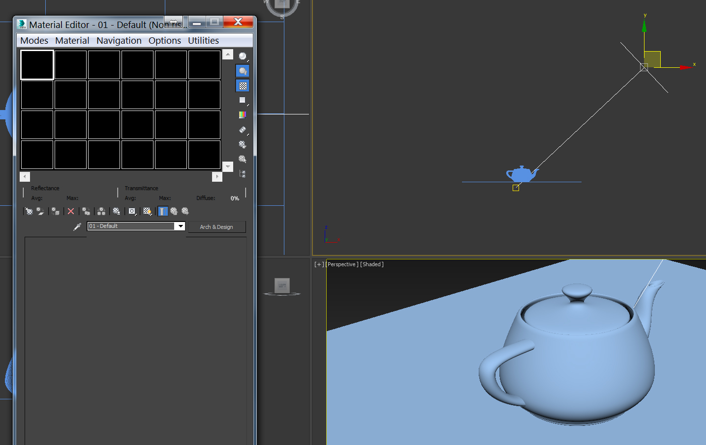

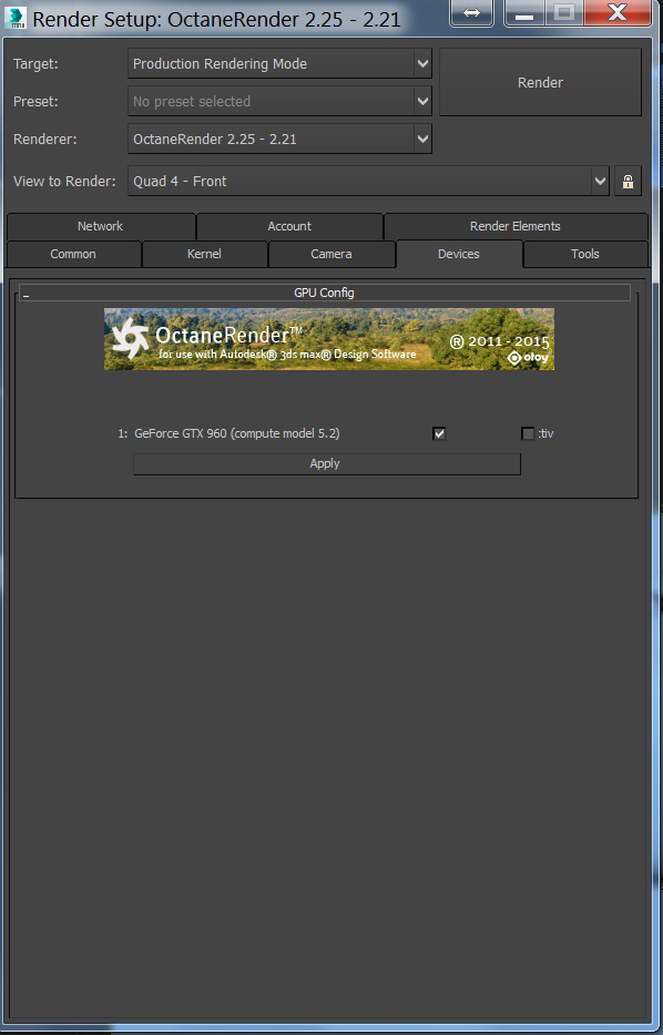

Hi! I installed version 2.25 Octane bought. But when I open the material editor window 3dstudio max everything freeze and the "sphere material" are all black. Not only. Often in the interface on render octane, in "DEVICE" not always show the video card. But also when it appears and open the material editor all freeze the program too. The operating system is Windows 7 Pro, video card NVIDIA Geforce GTX 960 with the latest drivers. I already checked with previous drivers but the problem remains. What happen? :roll:

Please confirm the following details:
- Version of 3ds Max
- Most recent version of the plugin to not have this issue for you (if any. This will help with narrowing down potential update-related issues).
- Confirmation that you have the Octane Standalone v2.25 installed
- Uninstall, and reinstall in "Administrator Mode" (eliminating the possibility of a corrupted installation).
This should narrow down the possible courses of action. Hopefully the issue resolves while you pursue the points listed above. Let me know how you go.

Ok! I solved the problem!!!!!!! the real problem was the "VGA onboard"!!! I disable it by BIOS not in this case by bridge on motherboard. Now on DEVICE in Octane I can see my Geforce GTX 960 and I can see also octane material in the material editor in 3dstudio max.
I hope this can help other similar cases.
