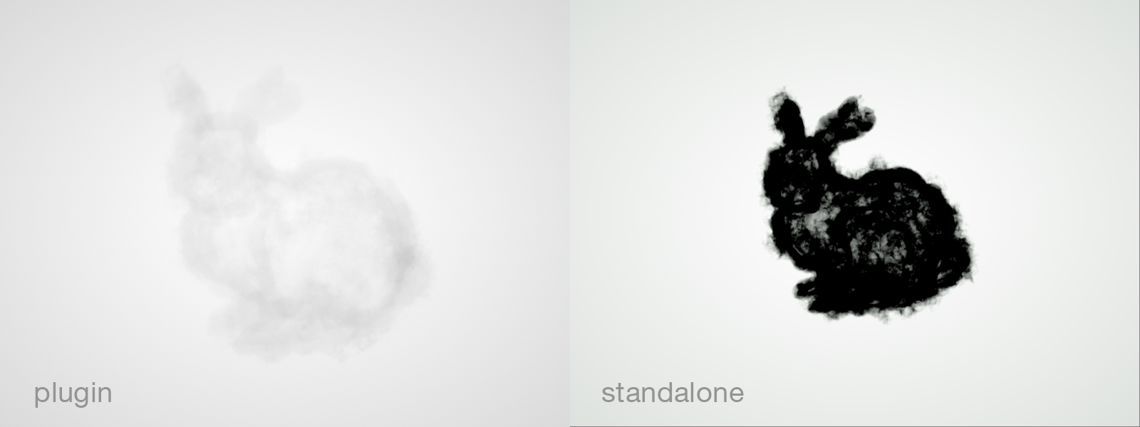

Hi Guys,

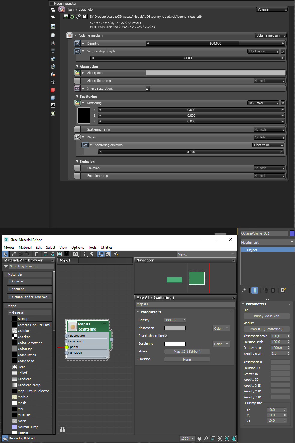

im kinda getting more and more confused about the differences between certain properties in standalone and plugin,
where do i set the volume step lenght in max ?
its really hard to understand whats going on if the same element is so different in standalone and plugin,
if im totally wrong here please advise what im doing wrong :)
standalone is latest Version 3.00 beta 1
max plugin is 3.00 beta 1 - 3.7
same goes for render results they are completly different in max then in standalone in default state

You have a volume medium connected to a volume node on a standalone screenshot, but a scattering medium connected to a volume object on a plugin's screenshot. Yes they are different. Because they are different nodes.
pixonoid
Posts: 26
Joined: Wed Sep 23, 2015 10:29 am
ok im officially retarded :),
edit:
but actually my visual difference is exactly the same using the volume medium, its barely visible
