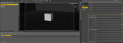

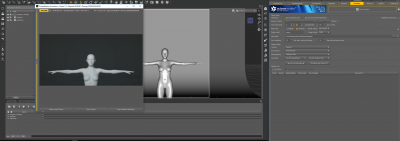

I don't really do animation renders but I was playing around with it last night and found this. I guess it's probably a bug but it might be something in my render settings or camera settings.
The original camera set up. Correct in the viewport.
The animation camera set up. Incorrect in the viewport.
Camera Settings
Camera Settings
I'm running 4.8 and 3.0.15.21

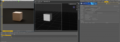

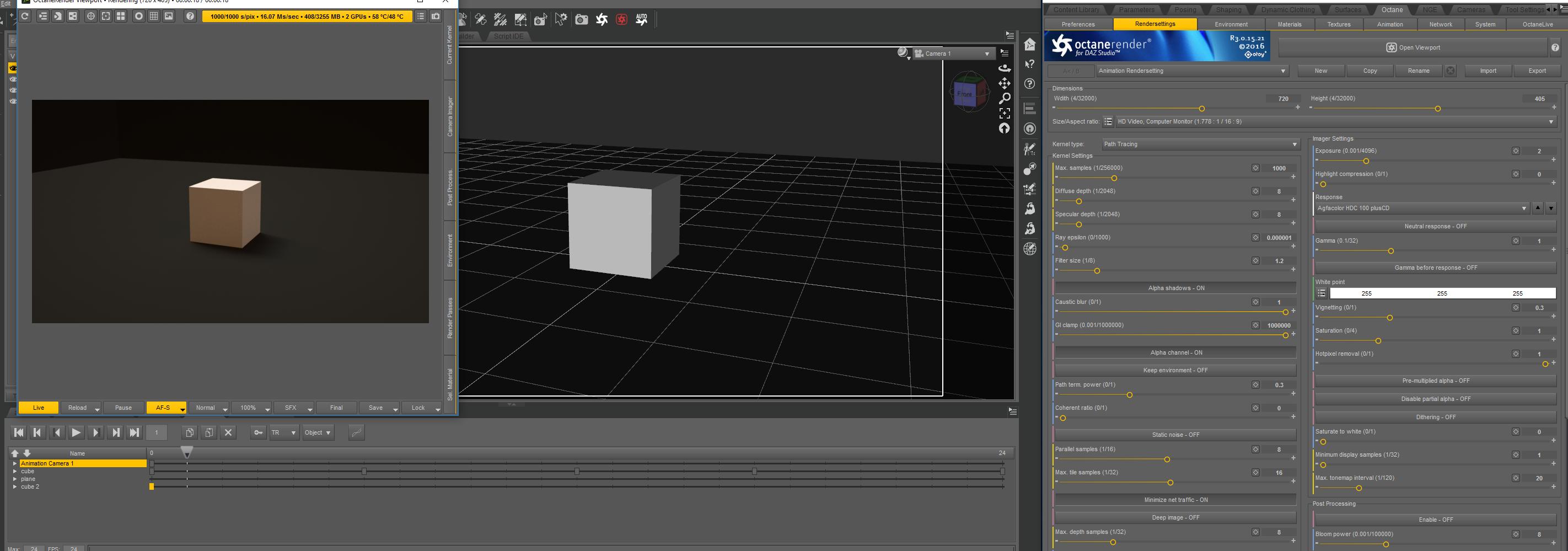

Sure. Here's another example.
Image Render
Image Render
Animation Render
Animation Render
Both the image render and the animation render are rendering the same frame of animation with the same camera. However, the animation camera's output is dramatically different. When the animation button is clicked to launch the rendering process, the aspect ratio in the daz viewport changes from 1.78:1 (as per the render settings) to 1:1. The animation will still render in 1.78:1, but it shifts the camera closer to the target. I suspect somewhere in the code the animation render process is converting the camera or render settings incorrectly.
I hope the problem is a bit clearer now.

The top two checkboxes which you have checked (To Preferred Size, and Size From First Rendersetting) will influence the camera/resolution settings.

face_off wrote:The top two checkboxes which you have checked (To Preferred Size, and Size From First Rendersetting) will influence the camera/resolution settings.
I have tested checking and unchecking those boxes. Same result.
User Error?
I noticed in your screenshots that you have at least two different custom cameras.
"Camera 1"
"Animation Camera 1"
In some screenshots in the DAZ Studio viewport you have "Camera 1" selected but in the Animation tab camera pull down menu there is "Animation Camera 1" selected.
In some other screenshots you have "Camera 1" in both.
So now I am not sure if the issue you are having is caused because you do not really have the camera selected in the animation tab that you actually want to use to render the animation?
But maybe something else is going on:
Software error?
I also did notice some weird behaviour of the OcDS plugin not really switching to the selected settings in the animation tab pull down menus when trying out render cues and started to wonder if OcDS might experience some issues if "Rendersetting" and "Camera" use different aspect ratio, render resolution aka "Dimensions" information.
compare:
viewtopic.php?f=44&t=53735
It actually could be that in a custom "Rendersetting" a value for "Dimensions" may be defined.
Then as well for the custom "Camera" a value for "Dimensions" may be defined.
-> If those two do not match when selecting different presets for cameras and render settings in the animation tab pulldown menu then maybe OcDS is getting confused which value to use...
So in that case the workaround might be to make sure you have the same render dimension values selected when saving custom cameras and render setting presets to be used in the same project.
