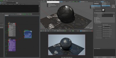

ivankio wrote: 2. viewport material appearance when working and making changes (specially transparency for windows)
viewtopic.php?f=28&t=52995
In the meantime, you can use this script.
It adds to the octane materials a "hardware Shader" attribute where you can plug a Maya shader to override the display in viewport 2.0.
(Though, it doesn't solve your issue for export)
