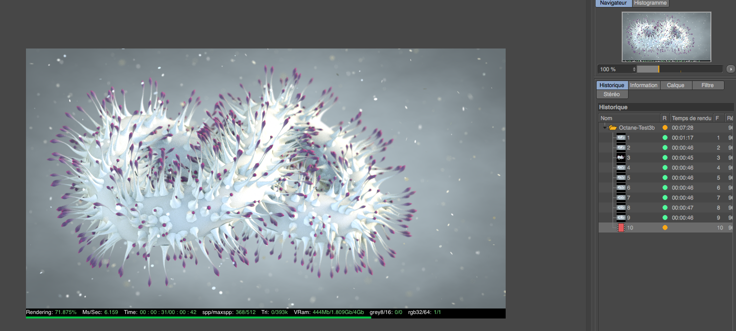

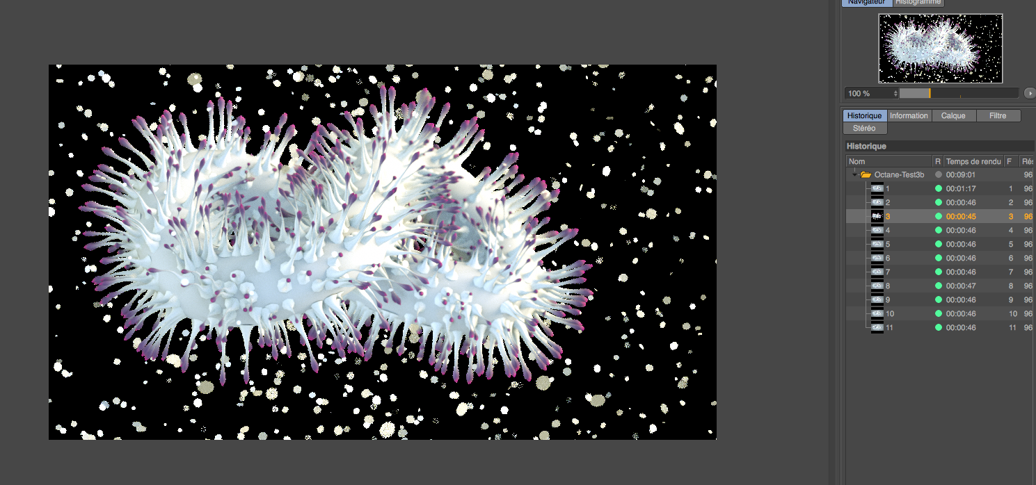

It seems i got some alpha appearing in some frames in the rendering. (actually always at least 1 frame) it already has been the second one, here is the third one. It looks a bit random.
I just use a c4d shader as texture background and allow alpha.
Is this a bug with the version ? or did i miss something ? :-)

Hi there. Thanks and welcome!
What kind of shader do you use on background object? I need more details to figure it. Maybe a bug or known problem about rendering c4d shaders. Best to see your scene's related parts.

Hi, thx for your so quick answer.
Actually it's just a gradient with small turbulence but it has 1 layer to color it.
That could be the cause ?
Is this supposed to be fixed with the final release of the V3 plugin ?
Gradients are so easy to make with c4d shaders :-)
I read for background purpose octane shaders are not advised. Is this right ?

C4D shaders are cpu based so we can't run them directly. Plugin render those to images before gpu renderings. Layer shader is causing problems on this rendering. This is not a thing about final release. I don't suppose that can be fixed. We'll integrate open shading language for custom shaders rather than using c4d shaders.
