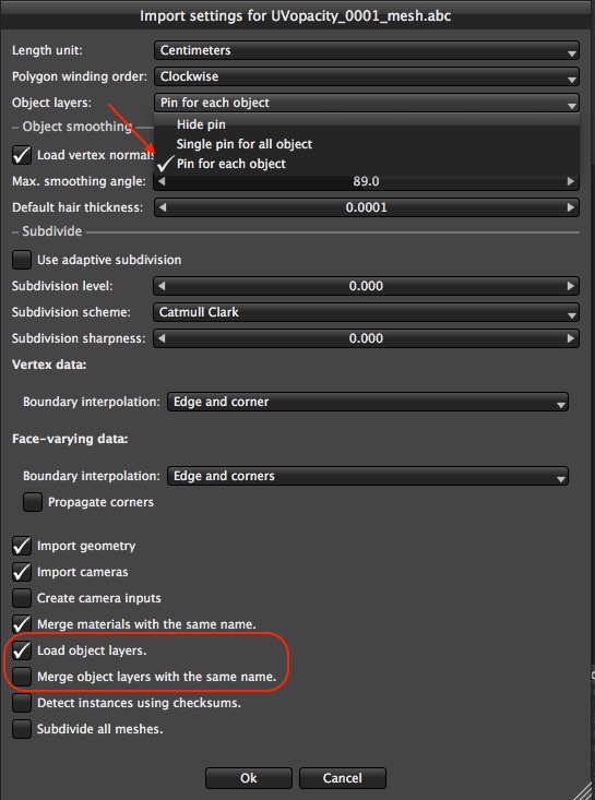

Not sure where to report things, but I am running beta 1, and noticed the "object layer map" node only works if you connect a "mesh" (.obj files) to it. It does not work when you connect a "scene" (.abc files).

Hi MagnusL3D,
you could edit the alembic geometry node preferences by ticking "Load object layers" option, unticking "Merge object layers with the same name" and by choosing "Pin for each object" in the Object layer pop up list: ciao beppe
