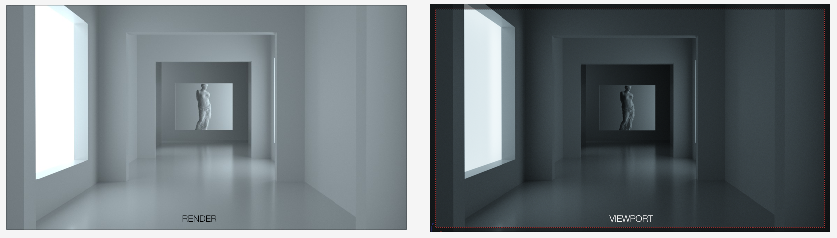

With the latest release (9.11) I've noticed that there is a noticable exposure difference in final render compared to the viewport render.
I have to set gamma to 0.5 in Blender's Color Management tab to match both renders. Since then they are almost identical.

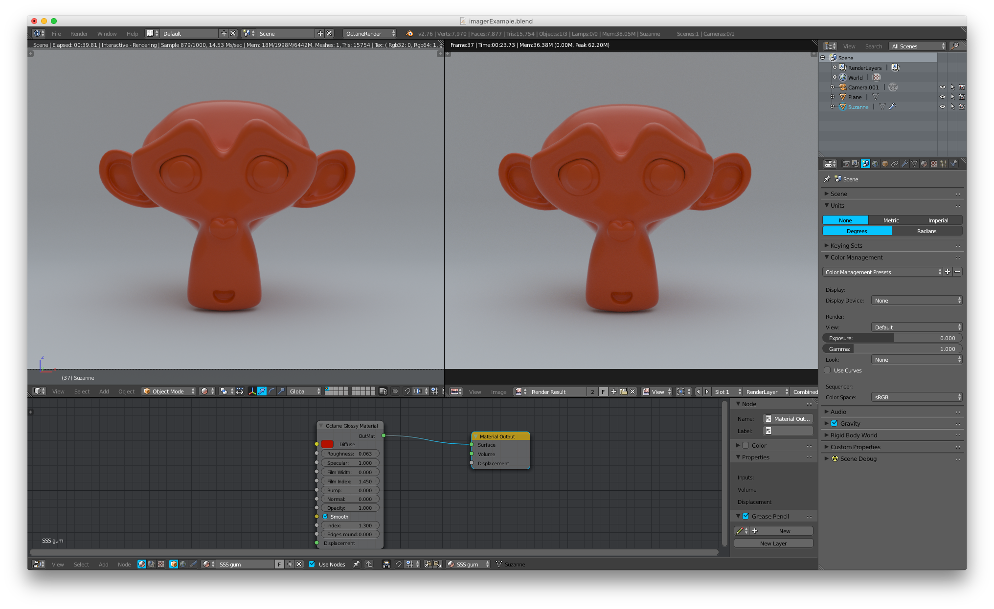

This does the trick! I have had sRGB switched ON and that caused the difference in rendered file.
The example attached file has the proper settings for viewport and final render.
imagerExample.blend
(732.48 KiB) Downloaded 374 times
