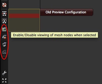

Can i also take the chance to ask in octane render stand alone.... how can i maintain in my live viewer the render target output while adjusting the matrialsx in node property otline at the right pane of octane. every time i try to select and adjust materials, the live preview changes to the sample sphere materials.

look at the icons of the toolbar of the node graph editor:
Schermata 2015-10-22 alle 16.32.09.jpg (17.57 KiB) Viewed 21249 times
they are very useful when working with nodes ;)

I can't believe I just know this after using octane for 2 years...
Thank you man! gordonrobb
